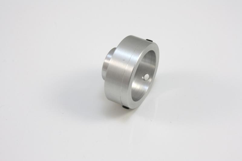

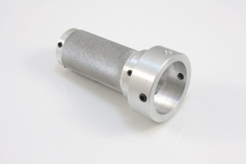

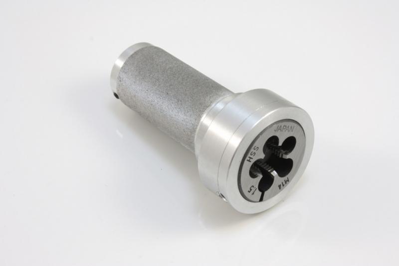

Seeing that I just paid for my triple start 14mm tap and die set I thought I'd better get cracking on making a die holder for the 1.5" die in the set.
I already have the die holder from Little Machine Shop, but the largest die it accepts is 1".
George's post got me thinking that the 1" die holder could be used to hold a 1.5" adapter.
So I knocked up a couple yesterday (one for a pen making friend)
Fred,
It looks like you took a little different approach from the way George did his. I looked like George mounted his adapter to the outside of the original holder where it looks like you mounted yours on the inside just like a die.
Can anyone help me understand how one would be better than the other? They both look great but is there an advantage of one over the other?

George has already answered your question Fred. I don't think it is a matter of which is better, I'm sure both will do the intended job.
As George said, the second version makes use of the existing grub screws and would be a bit easier to make because of that, only need to drill and tap 3 holes rather than 6.
I bored mine through to just over 19mm (3/4") so it can take dies up to size and still have some of the work pass through.

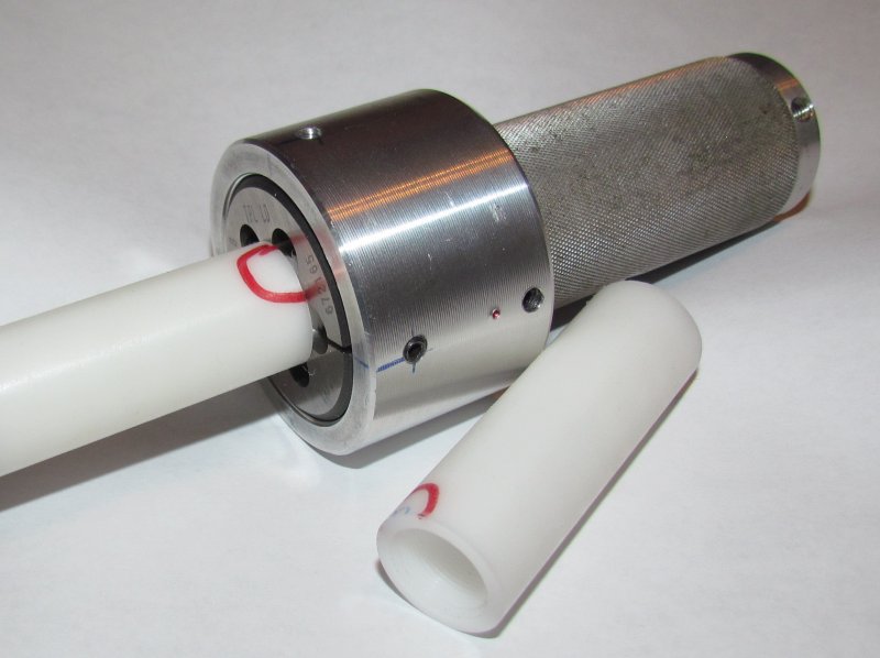

Well I got my die in yesterday so I finally finished drilling and tapping the set screw holes in my adapter.
I grabbed some delrin and made my first 14mm multi-start threads tonight and while my holder fits outside the 1" die holder rather than inside, I actually liked the feel when turning the holder. It's big and fits my hand well and is SOOOOOO easy to turn.
Now that I have the tenon and drill sizes figured out, it's time for a new pen tomorrow. :smile:
