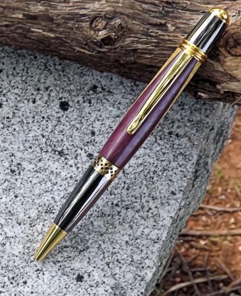

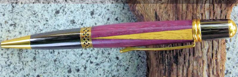

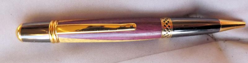

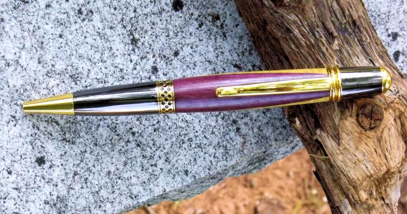

dbryce Member Joined Aug 2, 2010 Messages 17 Location North Carolina Jun 26, 2011 #1 purpleheart and canary wood wedge mesa kit from arizona silohuette Attachments pen p&y.jpg 22.3 KB · Views: 272 wcu pen.jpg 78.3 KB · Views: 268 yp.jpg 48.9 KB · Views: 327 western mesa.jpg 94.2 KB · Views: 233
firewhatfire Member Joined Mar 7, 2011 Messages 3,813 Location Columbiana, Alabama Jun 26, 2011 #2 interesting, do you just cut the groove and cut a wedge as close as possible and drive it in?
dbryce Member Joined Aug 2, 2010 Messages 17 Location North Carolina Jun 26, 2011 #4 I cut the canary wood in a wedge. I cut a purpleheart blank in half. I glue all three together with 5 mniute epoxy. It is clear so you don't see the gray lines from the regular epoxy.I also use it to go tubes into pens. They are not britte like CA

rizaydog Member Joined Oct 1, 2010 Messages 1,741 Location Wellsboro Pennsylvania Jun 26, 2011 #5 Very sharp pen.
G ghostrider Member Joined Feb 3, 2011 Messages 952 Location Grand Rapids, Michigan Jun 26, 2011 #6 Purple goes nice with the gun metal. Nice.
