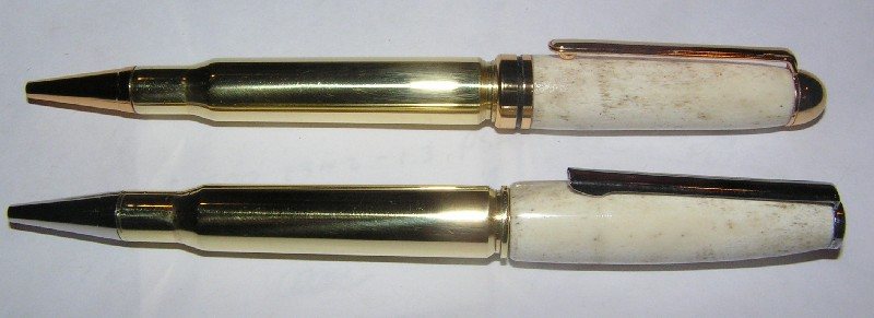

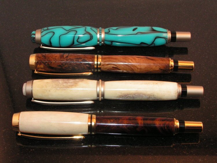

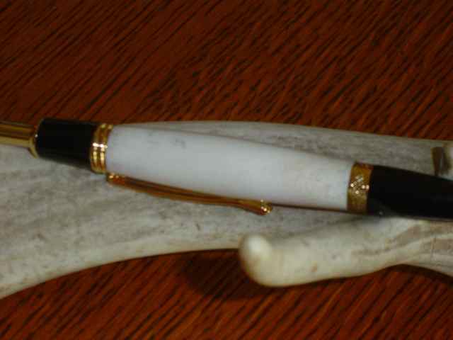

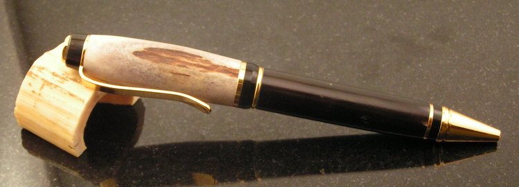

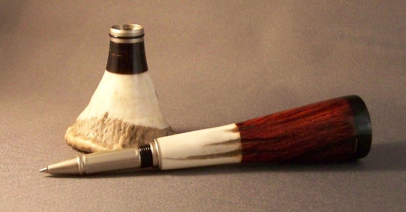

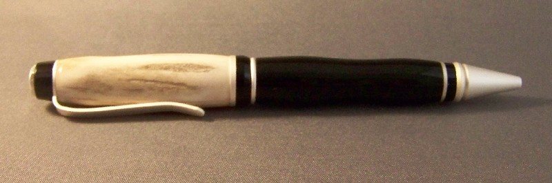

A few antler pens I had pics of handy.
last is Axis antler over Desert ironwood, above that is whitetail antler
Axis antler, cocobolo and water buffalo horn
Axis antler and gemsbok horn
Whitetail antler and Blackbuck horn
Whitetail and 30-06 brass
