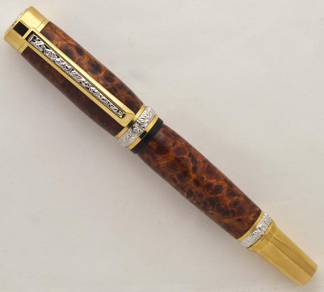

Made it this A.M. It's Amboyna Burl from Bad Dogs Burls on a Roman Harvest Fountain Pen from Timberbits. Hope you like it as much as the fun I had making it. Comments and questions welcome but most of all thanks for just looking. Doc:smile:

The insomniac is at it again, making beautiful pens while most of us sleep...Great job Doc, how do you like these set of components?
Lupe and Roy, Thank you for the kind words.
Roy, I really like the look of the components..but I do have an issue with them... that may be just me....but I would really like hearing from others. When you screw on the cap you have to insert the barrel/nib side very straight or the threads "catch". I looked carefully at the "evil" black band in my other pens and and am starting to see where that piece of black plastic guides the nib end in straight to make the threads engage without worrying about the angle at which the nib end is inserted into the pen. I used the cap of other pens with the black band on the lower of the Roman Harvest Pen and it screws on great:confused:. I hope that the above description of the issue makes sense. Regards, Doc
I think that is one of the nicest pieces of burl wood I have seen on a pen since I got on here almost a year ago and I love the kit. Almost bought me some but I cant sell them. NICE pen.
That's a very beautiful pen!!

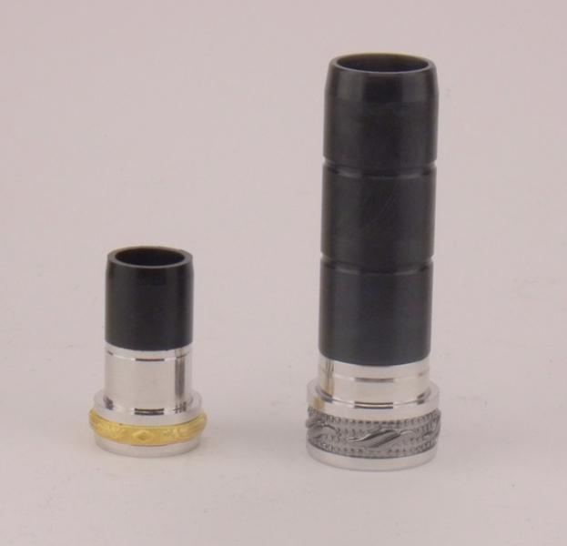

This snag is a real pity. Does it have a short threaded insert or the longer one like in the photo? ( I believe it needs the long one to keep it straight )
Steven,
It is shorter than either one you showed. See attached pictures. The actual threaded portion is only a little more than 1 cm in length. Is that the most likely problem?

beautiful pen Doc. What a shame how some of these plastic inserts come to be. If you have a collet chuck, you can just spin a 3/4 in long scrap of plastic to be the same as the inside diameter of the tube, then part it off, re-chuck it and drill the inside, then slide it in from the top. That way you only have to remove the top of the pen with no risk of damage to the centerband area.

I so totally agree with you about the threading issues. I have noticed since I got several of these kits that it is a pain to put on the cap. I have a guy that buys a lot of my pens and I let him try one out - he uses my pens at work all day long - and is constantly taking the cap on and off. After one day he handed it back to me frustrated with the difficulty capping the pen. One has to get it just right or it threads wrong. And how long will it take to ruin the threads by threading it wrong?
This kit has potential, I think, but there are kinks that need to be worked out and the kit components need to match the Cambridge Hybrid - including the tube thickness and bushings. I will not be ordering more of these until the kinks are worked out - and I hope they are worked out.

I just recently e-mailed David concering the cap and thread issue, but have not heard back as of yet. I think he made be out "fishing" again. I advised him of this link here on the Forum. Maybe he will reply here as well.

I've done one previous Roman Harvest Pen in Amboyna and had to adapt/stretch the tube to get my Churchill/Cambridge bushings to fit. As a result, with that pen, I thought the thread problem may have been due to the coupler being slightly off when it was inserted.
I waited to make this pen until after I got the right size bushings from David. Everything went together smoothly until I started to screw the cap on at even the slightest angle. At this point, I think that Steven aka Skip is right about needing the additional plastic threading and support at the coupler. I really like this pen and it has potential. I'm hoping we can get some feedback from David. Doc
Rich Kleinhenz wrote an article on improving the Statesman for a similar reason, and may be useful for this pen style as well. His article can be found here: http://penmakersguild.com/articles/improvingstatesman.pdf

John, Thank you very much for the article !! I read it and think a variation on that fix would work. I have enough of these pens that I don't want to lose so its worth it. Again, Thanks. Regards, Doc
