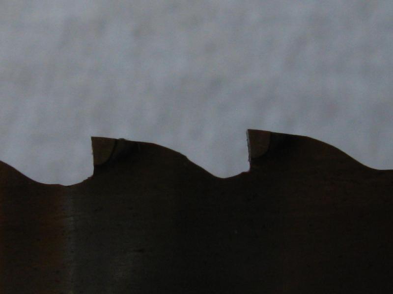

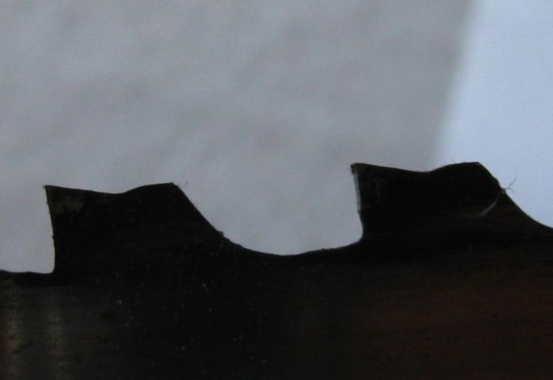

I just ran all 4 of my Laguna Carbide blades through a magnifier and have found no evidence of a problem with any of them. This may be a one of a kind problem but I would check your blades to be safe.
One thing that I noticed though was I have 2 different profiles on my blades.
