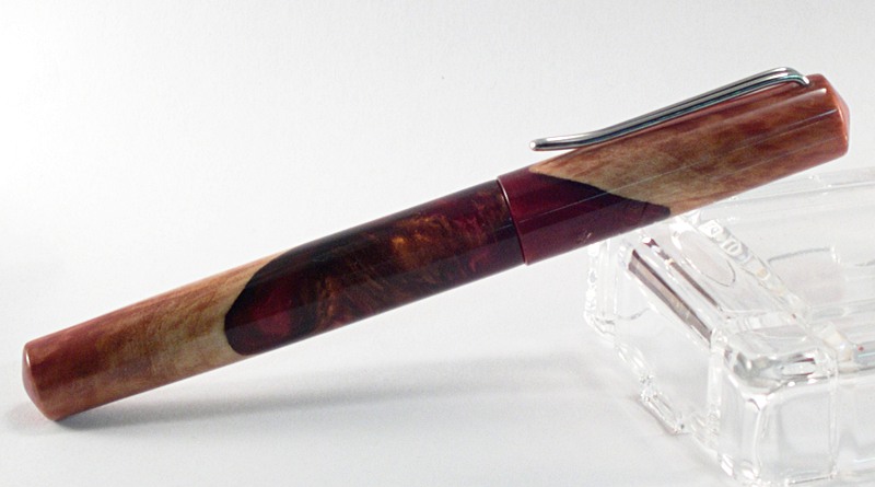

Had some problems with this one, but in the end, "Got 'er Done!"

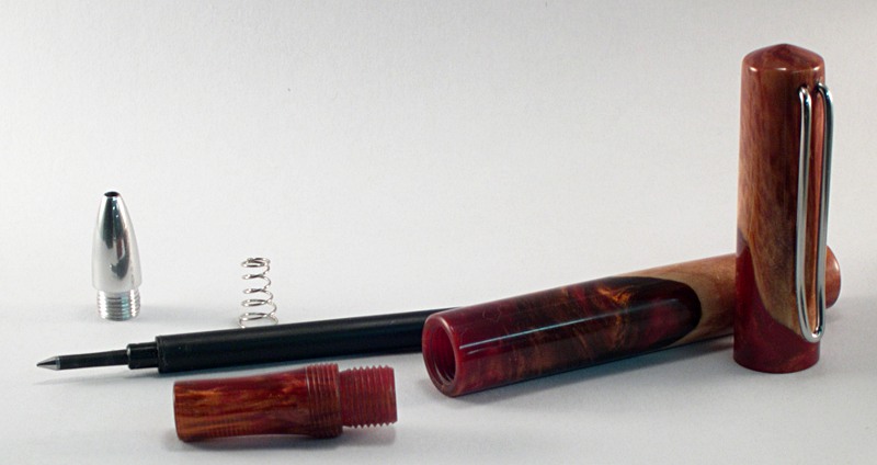

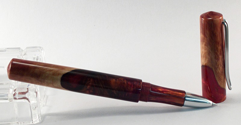

This is a kitless with Red Malle cast in Alumilite. The nose cone is made from Aluminum. the clip is Stainless Steel. The finish is CA on the barrels, with no finish on the section.
No tubes. Taken apart it looks deceptively simple. I used my new triple start tap/die I recieve this week from the group buy.
The pen is very light weight. Entire pen weights in at 20g.
The blank came from Victor at LandFillLumber. Victor cast this to my specifications. What a great Guy!
The Blank Story:
Most blanks are 5 to 5.5 inches long. I was telling Victor that he should sell some larger blanks, becasue these are just not long enough for a double closed end pen. And also, I need something to make the section from.
So, we came up with a 6.25" WW concept. similar other blanks he makes, just longer. Then added on the "Companion Blank", which is basically a sierra sized blank cast from the same pour, and is used to make the section grip area.
Thanks Victor!
