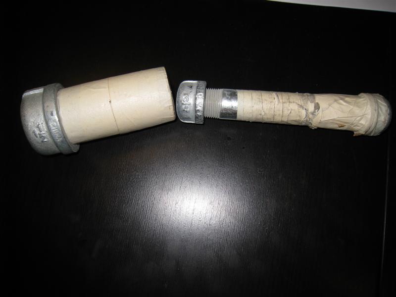

I use the pipes also here is a picture. I put tape around the pipe to make it a little easier to hold on too. The bottom can unscrew to dump out all the stones. I use this a lot to crush turquoise.
