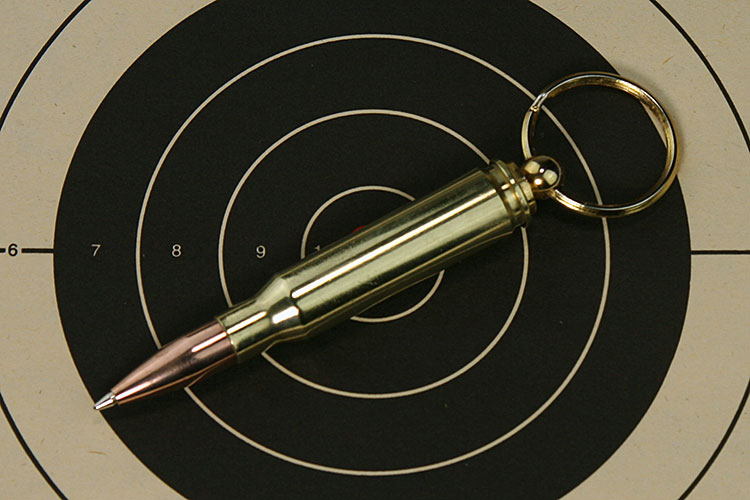

Ok, let's start out with a photo that exhibits incorrect white balance. I took this picture using "daylight" compact flourescent lights, but with the camera's white balance set to "shade". This gives the image a distinctly yellow tone similar to many photos I see posted on the IAP.

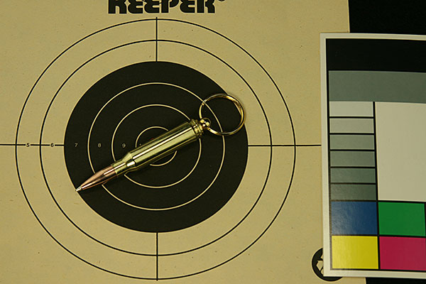

One can fix this problem in post-processing, but you need something in the image that is neutral in color (white, gray, or black). The photo above, however, doesn't have any neutral tones -- the target is beige and the black isn't pure. Therefore, I've zoomed-out a bit and put something white in it. I used a color card made for setting white-balance and exposure, but I could have made do with just a piece of white paper. We'll crop it out later.

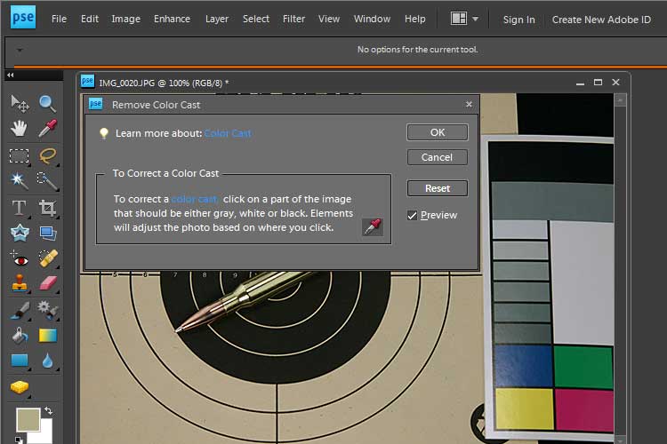

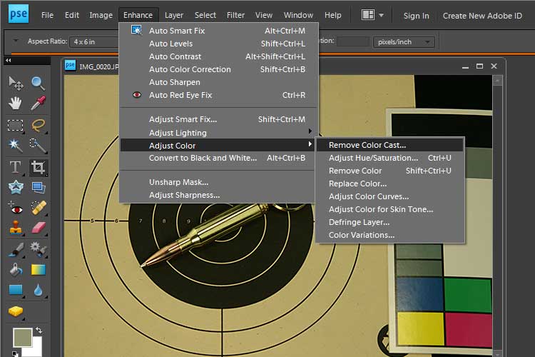

On the menu bar, click "Enhance -> Adjust Color -> Remove Color Cast".
This brings up a dialog as shown. The cursor changes to an eyedropper (not shown) and all we need to do now is click on the neutral color. In the image below, I've already clicked on the white section of the color card and the preview shows an image with the white balance set accordingly.

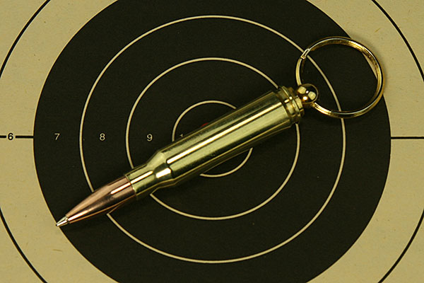

Click the <Ok> button, crop, resize and save the image as shown in previous tips, and we have the following result. That's it!
