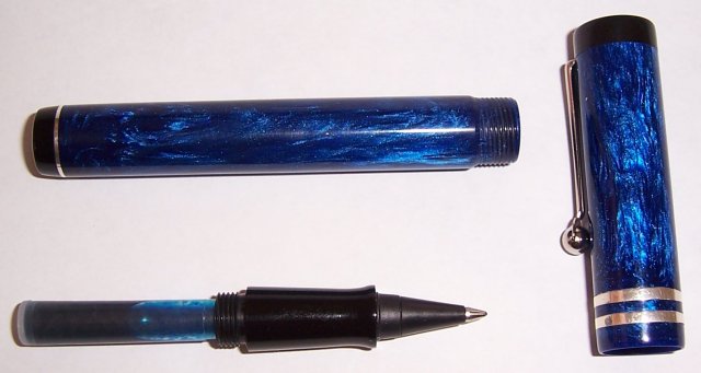

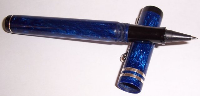

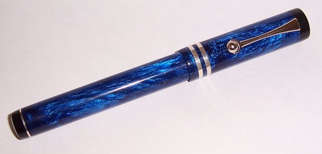

I hadn't made a pen in a long while but a week ago I got my shop kinda, sorta, semi-functional so decided to make a pen real quick to take down to Phoenix and show a few folks at the wood turners show.
This is a pen utilizing the new (to me) Schmidt rollerball nib that is fed from either a converter or cartridge refill.
I made the blank and front section from alumilite and PearlEx. The lower accent ring and upper double accent bands are sterling silver.
As a point of reference, this is the type of simple but nice pen that can be made using the new multi-start tap and die being offered by Turbowagon in the group buy section.
Pen Capped.
attachment.php
Pen opened showing rollerball nib which threads down into the front section. Lower body threads are triple multi-start.
attachment.php
Front section opened showing fountain cartridge. You can see my favorite Private Reserve color ink!
attachment.php

Nice Pen!! do you mind answering a few questions about the inside of the cap? I'm wodering:
Did you use any kind of tube inside, or anything to reinforce the segments?
If there is no tube, did you do anything to keep the threads in the cap from showing through?
Thanks!!

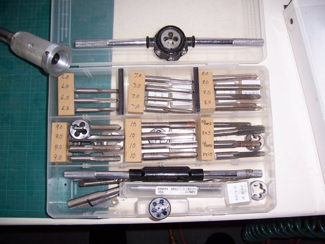

I have two sets of Taps and Dies in the shop (ASE and Metric) and other than the M10x1 which I bought separately I think I'm in for $50 on tooling so far. The big expense is the multistarts. The Die holder to make everything easier is about $30 if memory serves. and a Jacobs chuck is all you need to keep the taps simple.
George, are you saying that with Turbowagon's tap/die, we can make a pen similar to that which you are showing? Or, do you require more taps/dies than the basic that are offered in the Group Buy?
By the way, that is agreat looking pen that you are sharing with us. Love your work.
To be clear, you don't have to buy the tap and die in Turbowagons group buy, you can use any single start tap and die out there. I just like using the triple multi-start threads for several reasons. I'm just showing what a pen will wind up looking like with the triple multi-start threads on it.
As I stated, I used four different threads in making this pen. Could I have used fewer... yes, but I chose to make the pen this way. After LOTS of trial and error, I have settled in on my favorite threads for certain things and to me, it's easier to just cut some threads than glue two parts together.
As an example, I have a favorite way of installing the clip in which I thread the finial so it easily comes off in case the clip ever breaks. Some just glue the finial on so no need for a tap and die then.
I went down and took a shot of my tap and die box to give you an idea of what I use. Without going into a lot of boring detail, before using my metal lathe more and more for threading, I was regularly using only five or six of these taps and dies.
I found that going out and buying a huge set of taps and dies was a total waste of money since most of my "regulars" are not included in the sets! Some have gone to great lengths to persuade others to buy sets so I will not try to dissuade anyone not to, it's a pointless argument so buy what you feel comfortable with.
Since cost is a concern to some, I would say that aside from the multi-start tap and die, you could get all the other taps and dies you would ever need to make nice pens and a mt-2 die holder for well under $100. At Victor Tools ( http://www.victornet.com/ ) all the oddball sizes usually not included in the sets can be be found, usually for $4 or $5 apiece.
Remember, I bought these thinking I'll have a nice selection if needed but some have yet to be used and some only once or twice.
Thanks!!
Tubes......... we don't need no stinking tubes! :biggrin:
There are no tubes in the pen since I don't need them for anything. There are no segments either. I think what you might be referring to are the silver bands which are not segments but are solid bands swedged into shallow grooves in the cap.
The blank I made is solid enough that the threads do not show through.

Speaking of the colors and keeping in mind I sorta threw this together rather quickly.... I am having mixed thoughts as to how the pen would look best.
Part of me likes it the way it is, part of me wants to "balance" the pen by adding a silver ring just below the cap finial just as the lower finial is seperated by a silver ring. Whatcha think?
I think the pen looks great as-is.
Are the silver bands strips that you wrap around the barrel? If so, how obvious is the seam?

My impression was that the upper sliver band was missing...
Was the swaging procsess trial and error, or did you just swage the band then turn off what was left?
