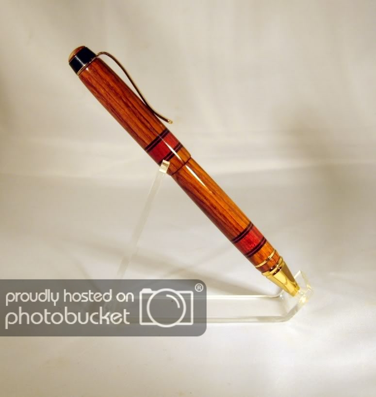

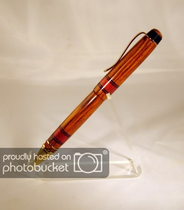

Here is my modified cigar entry. The center coupler is turned down and hiddin inside the upper barrel. The upper barrel is longer than the lower barrel. The finial and nib trim ring are both made from cocobolo. The woods are cocobolo, blood wood and black and red veneer

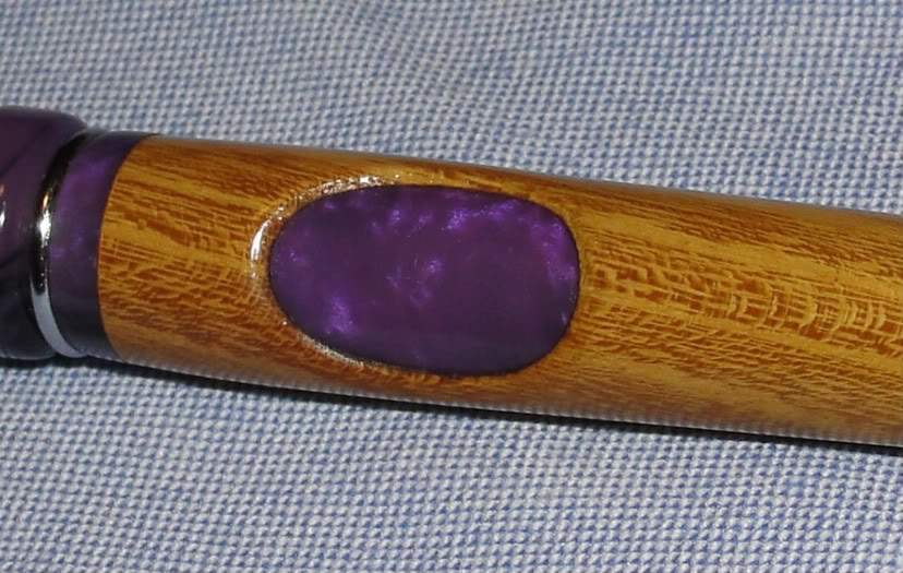

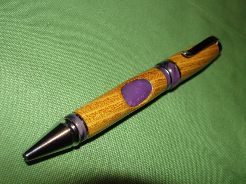

Peak a boo Window
Custom cigar that still have the cigar look .
center band upper - replace with custom
nib band replaced
and a close up on the window

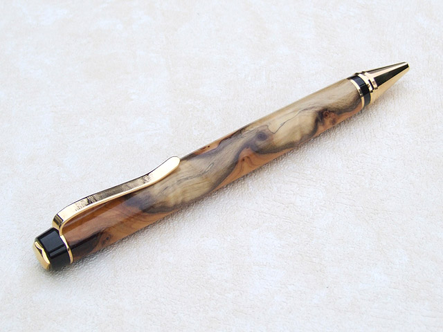

Entry for the modified cigar.
Mesquite with gun metal components.
Modification is simple, used two lower tubes. Turned both top and bottom to match center coupling ring and did not use the center band.
Finished with BLO/CA, MM to 12K then one step polish and wax.

Modified Cigar
Ok, I'll try again to attach the image of the modified cigar. Previous post has the details. (I'm just not too bright sometimes, OK most of the time!)

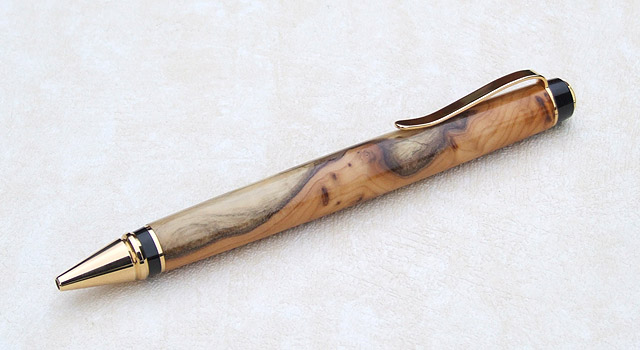

This is my modified cigar pen entry. Actually it's a modified cigar twist pencil rather than a pen.
My goal was to streamline the pencil and to elinimate all the black kit components.
Desert Ironwood with gold hardware. CA finish.
Modifications:
* Longer lower barrel to eliminate nib trim band
* Longer upper barrel to eliminate center band
* Matching finial

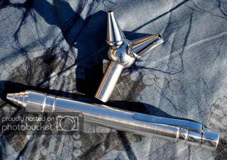

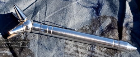

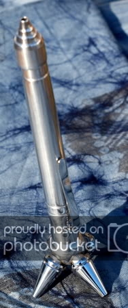

Meet "Shopzilla" ! Not a pen that fits my inventory, but definitely a cool pen to use in the shop. A total aluminum experience, finial twist activator which also acts as a pen stand containing not one lowly cigar kit nib, but 4! Yea...you said I have to use a cigar kit nib, but didn't say where. :tongue::biggrin:
I sure wish I could give ya better photo's. My camera is awesome, and I have tons of lights, but I can never get the lighting right and never manage to get the focus spread evenly across the pen..drives me bonkers.
Edit...new photo's..these are a bit better..tried a regular lens instead of macro and went out into the freezing cold to take photo's.
maxman400
May 25, 2009
3,111
Omaha Arkansas
I Don't Know???????? Is 4 pens kits in 1 Pen legal, LOL .... I Like it and Butch did say
"Now let's see some wild Cigar pens !!!"
Way to go Jeff.

thanks Max..it'll be a way cool pen for personal use in my shop and conversation. If you set it down, it can't roll and it stands up on end like a rocket too. I thought it was a clever way to have to use a cigar kit nib and I have a ton of discarded ones, so I just blew threw at least a few. :biggrin:
I just wish I could take good photo's..I can't get the camera to focus the length of the pen..even with manual focus I can only seem to capture one end or the other in focus. :mad:

Jeff, when Gerry was still around, he answered that problem for me.
Use the zoom lens. Move the camera further away and then zoom in to fill the frame. I never use the macro function unless I need a serious close up. All my pics are taken with the camera at least two foot away.

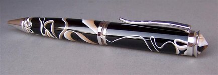

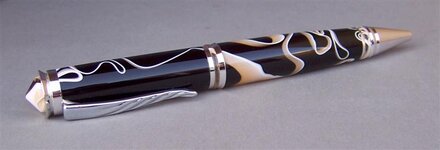

My entry the pen has a cut down Retro final and is threaded and attached to the cigar clip the finial is also matching Lucite! the center band is Retro with a matching Lucite band the Nib band is also matching Lucite all reverse painted.

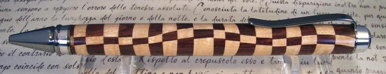

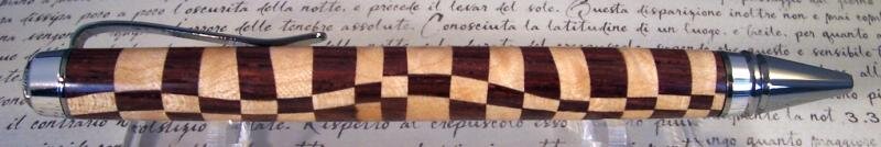

Here is my entry. One piece with a segmented Maple & Cocobolo body, mounted on the Hybrid Cigar with Black Ti & Platinum. 15 coats of CA sanded to 12,000mm and polished with PlastX.
Was on vacation and just saw the contest today...see now that it's too late, but will share these anyway...just finished last night.

Rich;
awesome, very original blank...nice work!
John,
I love your entry. Pairing the cigar and retro hardware looks great! The great blank wraps it up nicely. Very inspiring.

John would have had my vote too. I thought his was the most visually stunning of the group. Great work.
