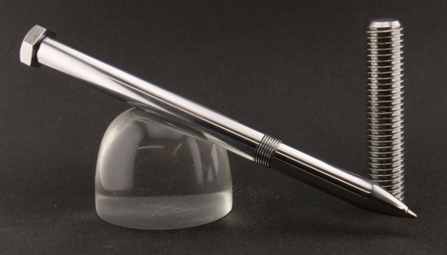

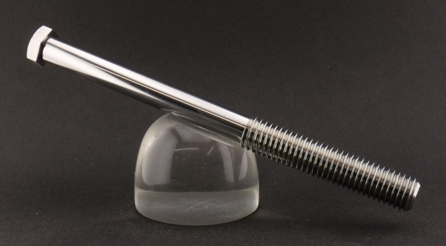

I've been playing with my nuts and bolts again!!:biggrin:
I must admit, that's when I have the most fun.:tongue:
There is actually only one small bolt here. That's the part that has the hex head. It is unscrewed from the body shaft to change the refill. The body is one complete piece. The 'cap' was simply a piece of M12 x 1.75mm all thread drilled and tapped with M10 x 1mm. All in stainless steel.
I love making these 'fun' ones and hope you like it too:biggrin:

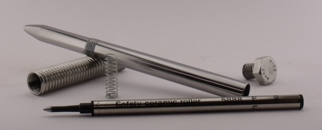

Here's a pic of the bits. The M8 bolt on the end presses down on the spring for the RB refill. I made the nib end ( inside) suitable for either a RB or BP. I just need a spacer to make up the difference in length.
I kept the 'brand' name on the end of the bolt.:biggrin:
Thanks again:smile:

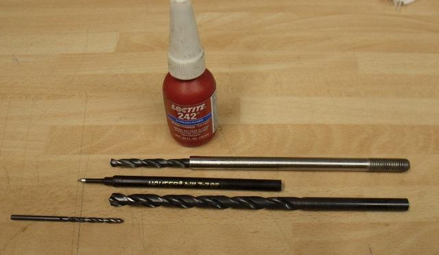

No special tools required, I promise. One long 7mm drill available from anywhere. One 2.5mm drill for the tip of the refilll.
Now drill a 5mm hole down a shaft of 7mm or slightly thinner. Loctite the drill in the hole you just drilled and allow to dry. You now have a long drill bit for the nib seating of a RB refill or for the recess for a BP spring.
