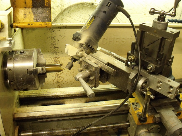

Question; How do you make a herringbone 360 in the middle an existing blank??:confused:
See if you wizards of segmenting can figure it out!!:biggrin:

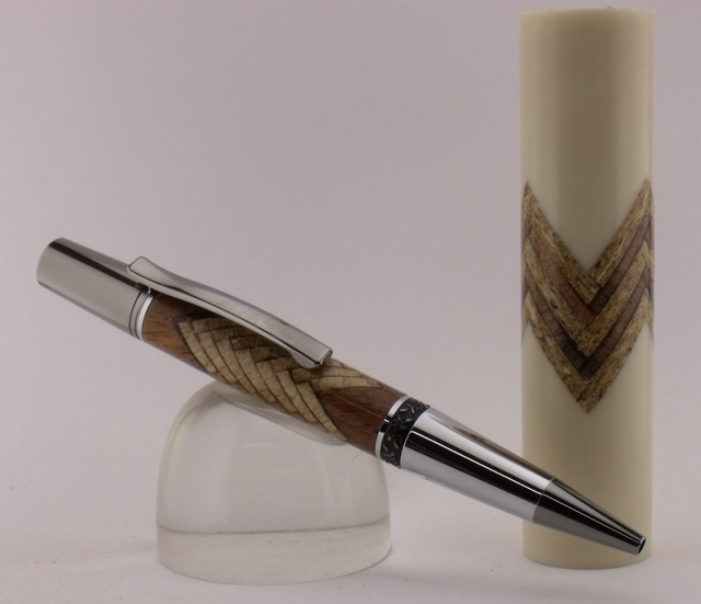

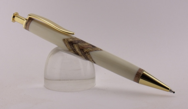

The finished pen was my first attempt doing this but the joints weren't great. I then did much better joints inside a rod of alternative ivory, but I messed up the sequence:mad:. But I'll still use it.
There are seven 'layers' in the pen and 5 in the alt ivory. I think this cool way of doing it if you get bored of making a ton of little squares:biggrin:

I can get the end pieces with a rotary table and a slitting saw (metal lathe stuff) -- but that is probably not the way you did it.

I think a vision came to me of a metal lathe that looked like a "transformer" had landed on the cross slide. An interesting way to do that and something like a Ornamental Turning Lathe.

I think you used your router attached to your metal lathe to shape the solid blank and then layered your herringbone pattern in the middle. Wonderful idea and follow through. Im waiting to see the all metal herringbone from the master ratty.

Interesting!! But did you set the router at a 45 to the lathe bed, or mount the blank at an angle and run the router parallel?:wink:
Well spotted!!!:biggrin:
LOL, the pic that some people are referring to is NOT exactly how it was done.
Here is how the tools were set....
Router set at 45 / 45 ( compound ) Slide vice holding topslide at 60 deg
Tip of router cutter set on centre line.:tongue:

I must say Skip that is some ingenious fixturing!! Nice mill, is that a small plunge router or a large Dremel tool??
Ken, I think it was called a 'Laminate Trimmer / Router' when I bought it years ago.
I think it's intended use was to open up dry wall electrical conduit boxes.
I got it from a supermarket ( el cheapo) but it's one of my most used tools. I've never seen another one since and I really will cry when it eventually packs in.:biggrin:

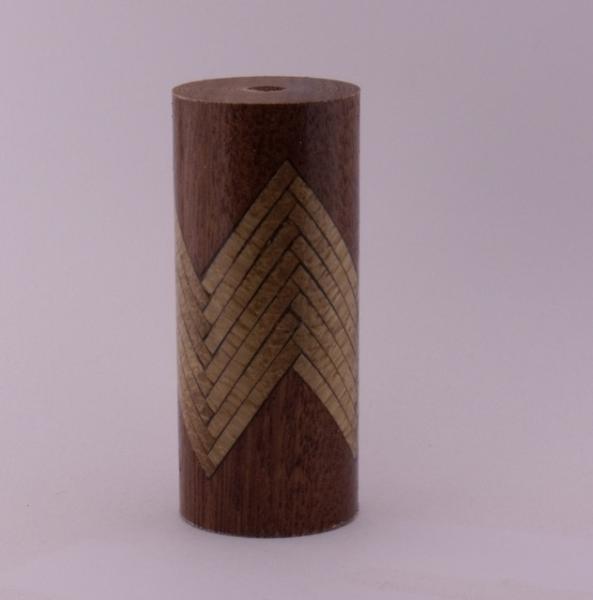

Here's a pic of the other blank on a long clicker. I had to add the 'oops' bands to make it long enough. :biggrin:

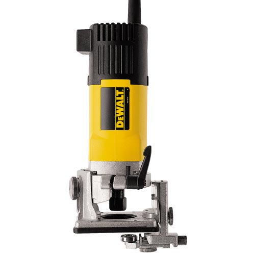

Laminate trimmers are pretty standard gadgets here, the trick is getting one that can easily be removed from the base and held in that handy dandy little toolpost extension gadget. I think one of these with the split collar holding the motor onto the base would be the easiest to adapt once yours finally eats the big one.

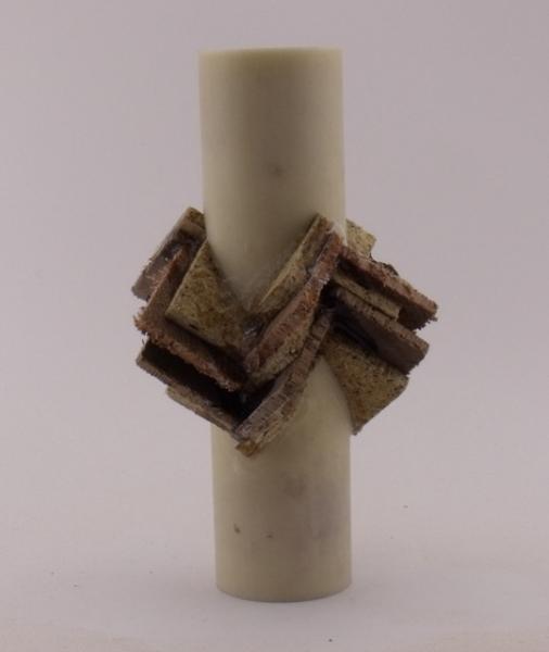

My first thought was the thickness of the segments were the same as the the blade, but after the comments about routers, I'm guessing you cut out the entire section of rod and then filled it in.
