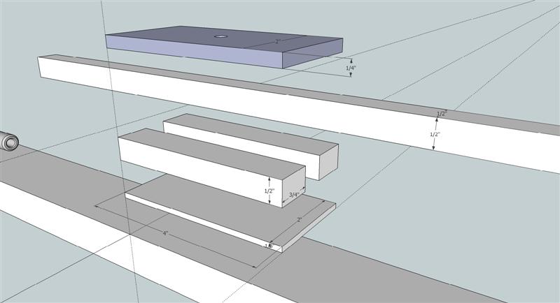

Square dowel assembly jig:
I haven't built this jig, but I don't see why it wouldn't work just as well. I think that this way alignment would be a bit easier, plus you don't have to drill the long 1/2" hole.
here is a detail:
attachment.php

I just realize I made a mistake in the square dowel drawing.
the center of the dowel has to line up with the center of the plunger. so the bottom wood block should be just under 0.75", not 0.125". as mentioned, the plunger here is .97" high.

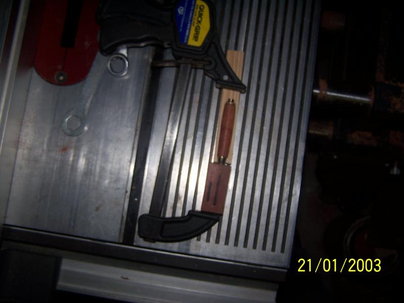

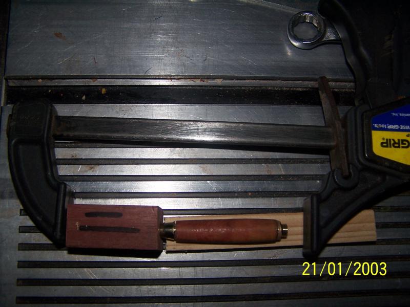

I put the nib in another blank with the hole in it. Then I put a board from one end of the clamp under the nip while I squeeze the clamp. At work now, I can send a picture when I get home.
Would love to see a pic of this.
I've been using a simple squeeze clamp purchased at Home Depot. Has orange pads with a trigger grip. I'm sure it's not the best. Looking to get ideas on something better to use. I've been just holding it with my hands to clamp it in. I do my best to keep the nib centered. I've pushed it in by hand as much as I can but it still gets angled some when pressing it in.
Jim
Been there, done that. The small hole in the nib would always punch out some yellow rubber from one of the pads, and I always had to find a way to fish it out ( beside the fact that it ruinsthe pad). And I now find out with my new jig that I can use my elbow to press down the clamp, which leaves me 2 hands to hold the parts!
