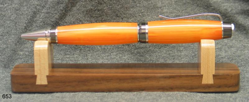

This alt amber is reverse painted with Apple Barrel Pumpkin Orange --seemed like a good idea at the time but I prefer the result of others' colors! I didn't have any trouble turning the resin but it is near transparent so reverse painting is a must (and polishing inside the blank wouldn't hurt either -- I can see a few drill marks in the blank interior even with painting).
Just another example:

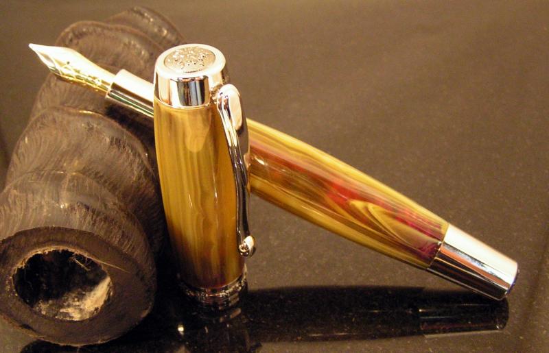

I love this stuff! Some of my favorite pens are done in it, including my last limited edition, serial numbered statesman. This was actually destined for a plain gent, but the paint job on the tube didn't work out the way I planned. It grew on me after a while though, and I ended up doing this with it.
