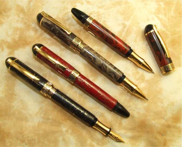

Haven't seen to many of these posted or I just may have missed them. But I ordered the new Apollo kits from PSI when they came out awhile back. Thinking it would be the same tubes and drills as the Churchill. Well so much for me thinking, the cap needed a 9/16 bit and there was none to be found in the shop with about a 100 drill bits I have, so these got set aside until today. The bits I used were a 9/16 for the cap and 12.5 for the body. I like how the plastic sleve hides itself out of the way on the cap coupler. Threads seem to work good and the back threaded endcap even looks good. I did not like the look of the ALL gold bands, so I used some Rub in Buff and darkened the inside of the bands. Not sure how it will hold up, but gave it a go anyways. On one of the pens, I left off the end center band to see what it would look like. If you do this, you need to turn down the end coupler because it widens to hold the denter band. Well here are the ones I made, I just might order a few more :)

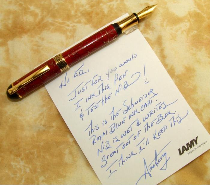

What do you think of the nib, Anthony???
I inked this pen Ed, just so I could answer your question, I need another Pen like I need.......Oh well, it is a nice pen :)
Put a Schneider royal blue cartridge in it, and the pen took off just great, no skip, writes good.
I agree, the pen looks better without the end centerband when posted.

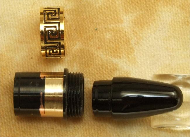

Yes. the end coupler messured .558 at the beging of the coupler when you go to seat it. The coupler then increases in diamiter to .572, this is to hold the center band. So I put the coupler in my Beall chuck and removed the excess metal on the coupler so it would be .558 all the way. It you do not remove this metal, the coupler will not seat or if you get it to seat, it will expand your tube to much and damage the pen.
PenWorks
Aug 18, 2004
5,186
Scottsdale, AZ
Ed, here is a pic, probablly better than me babbling about how I did it. The shinny brass is the area I removed the metal from.
