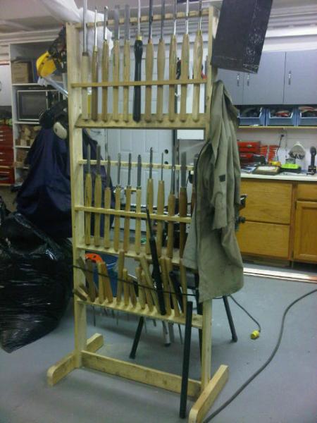

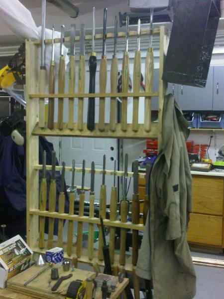

Here is a rack I like as I can put it where ever I want it..
Lin.

If you need more space, consider putting a second tier on the rack at a smaller diameter and height for your smaller tools.
