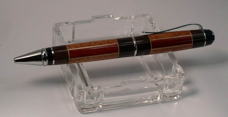

This is a simple cigar mod that I like. I'm sure its been done before, but I thought I'd post it for people who havn't tried it. It really changes the lines on the pen (I like it better). It shortens the pen a little, but I find the length to still be good. If you wanted to retain the original pen length, you could get a longer upper tube.
First pic is the pen. I simply left off the CB, so the coupler ring showing is all there is for a CB.

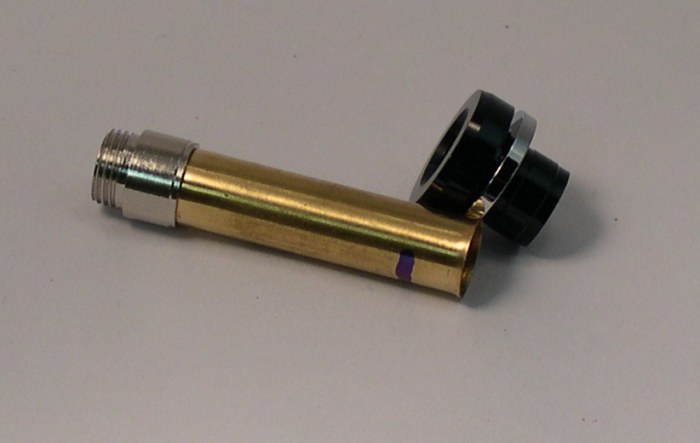

To do this you need to shorten the activator tube by the length of the CB. Pic 2 shows an activator marked for cutting. I used the band saw.

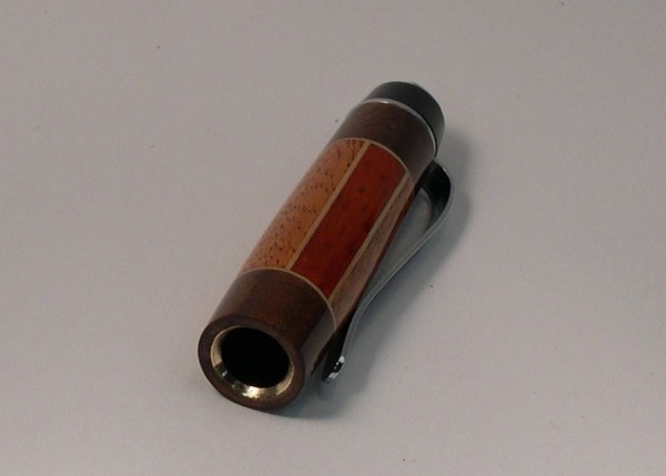

To keep the upper tube from feeling loose, I pressed a portion of the CB into the tube, I mounted the CB between centers and turnd the thick part down to the tube inner diamerter (sorry, no pic). I then pressed what was left of the CB all the way into the upper tube. Pic 3 shows the tube with modded CB pressed inside. I used a countersink bit to chamber the brass, which improved the fit against the coupler.
I turned the center smaller than the coupler ring. The ring is rounded over, so I intentialally made it so the rounded ring sits proud of the barrels by about 1/64"

I love the cigar style, OTHER than it's center band which never sat right for various reasons. That is a nifty mod and a very nice looking pen! Thanks for showing.
Good job Dennis , it looks great . Another way to handle the looseness of the upper barrel without the CB is , instead of cutting down the CB , drill the upper blank from both sides . Use the drill you would use for the tubes but only drill 3/4 of the way through the blank and cut the tube to fit and glue it in , then drill the centerband side with a smaller bit , same size as the hole from the centerband . Now the blank will fit correctly over the tranny and you can still press the finial/activator tube into the tube in the finial side and if you cut the blank a little longer to make up for the length of the CB , you don't have to cut the activator tube . I really do love cigar kits , they are even more versatile then slimlines .
That mod looks great! With a really nice blank such as the one in the photos the center band can be a distraction when the pen is finished. I'll have to try this although I'm still working my way up to blanks like yours.
I thought over-hanging the wood, but with the segmenting I didn't want to risk it. I also thought about getting a longer tube, but decided just to use the kit tube and have the pen shorter to see how I liked it.

Question for you..... I gave this a shot myself, shortening the activator tube like you did, but the top of the transmission tops out in the fineal/plug (whatever you call that bit) and prevented the blank from coming all the way down to the band. Is there something I missed? Was your blank make a bit longer or?? I can't see a mechanical way to do this OTHER than making the blank longer.
