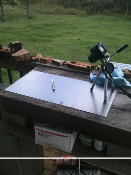

I spent alot of time and alot of money (for me:mad:) trying to get some good pics but I was wasting my time. I dont have the skill or the knowhow for the photography thing. I had seen Liggets photos and reading about him placing it on his front steps. I had a hard time believing it.
So I tried it. Whoa!!:eek::eek::eek: Took apart me tent and decided to take my pics outside from now on.

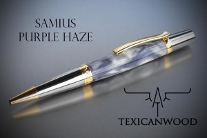

Just a plain piece of steel I use to place my pans on and shoot with my wifes Fuji 1000. I clean up the dust with PSElements 6 and add vignette(sp?), brand it and label. Here is the pic of the pen I was shooting at the time.
Anyway here is a shot of my "studio".

I'm like you, absolutely no skill at taking pictures. I had heard natural light works very good for photos. Next time I'm going to try your suggestion.
Thanks for sharing.
Carl
Awesome, I may have to try that myself. Very frustrated with my photos. What do you do when it is cold out? Oops, never mind you are Texas, probably don't get snow in your parts.
The first pics I took with this setup were taken in early Feb. As long as I got a fairly clear sky and a bright sun Im good. My "shop"(back porch) is facing east and as soon as the shadow falls past my "studio" Ill start shooting.
Now trying to get them pens out of their little winter coats is another problem.:biggrin:
Thanks for the feedback guys. Its an easy set up. Not like before when I would drag out my tent and lights AFTER the kids went to bed to have some peace and quiet. Then spend hours trying to get a decent shot only to spend more time in photoshop.
I took pics of 7 pens in a little over 30 min. That would have taken a LONG time with my old photo tent set-up.
I like taking my photo's outside, but others jump me about the trees/buildings/whatever being reflected in the pens...how do you get around that?
Like the idea of using steel. Sort of reflective, but not overly so like mirrors or black glass....works well. What are you using to keep your steel from rusting or getting scratched up?
Scott (seems you have a good set-up) B
After each shoot I will spray it down with WD40 and keep it inside behind the couch. When Im ready for it Ill just wipe it down. I guess Aluminum or Titanium would work too just not sure on the price???
As far as the reflections, I dont have a problem with them but I have thougt about using the white tent material in front of the pen so the reflection is of the "tent". Dont really know. Havent tried it. Or maybe even shoot from a different angle???
I also like shooting outdoors. The steel is a great idea. I like the soft shadow. I usually use a towel or piece of material so that I get no shadow at all. I always shoot in the shade, usually on sunny days. That way you get good light, but no shadows or reflections. But cloudy days work also.
