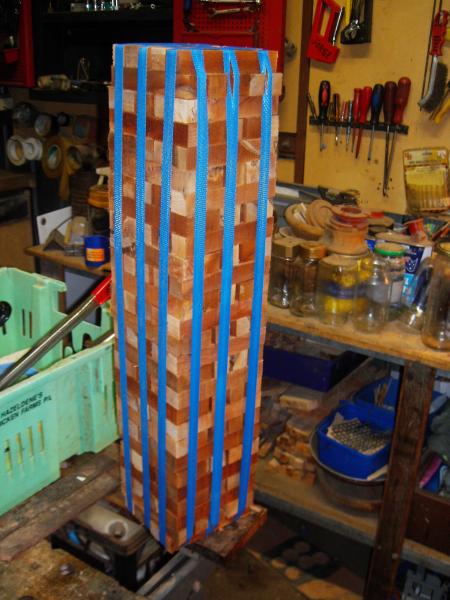

Pen blanks on the other hand, seem to do well cut green (couple of mm oversize) and waxed in the end grain. A good idea is to stack your pen blanks like a "drying tower" as I call it (pic attached), spaced (4 blanks each direction) and strapped, as this makes the handling of the blanks easy, take little room and reduces possibility for warping...!:wink::biggrin:

The warping can be "significantly" reduced if you stack them in such way so that air flows between the blanks but they are "braced/rapped/strapped" in such way that keeps them all in a tight bundle.
I have hundreds of pen blanks drying at one time, spaced and stacked freely but, if any of the woods that I'm uncertain or aware that they will move considerably, I strap them in stacked piles, to which I call, "drying towers". You can use wire to strap them with, if nothing else is available to you and, as they dry and the bundle becomes a little looser, you just re-tight them again...!
I'm adding a few close-ups of the "towers"

Man, George, my puny little "tower" looks downright insignificant! But I stacked it the way you showed me. I didn't strap it, but if it looks like it will warp I will. I dipped all the ends about 1 1/2" in hot wax. Hope that does the job. The bowl blanks were already cracking, but the one double wrapped in two plastic bags would have still been turnable. The other one, already cut round, was so badly cracked I couldn't turn it.
