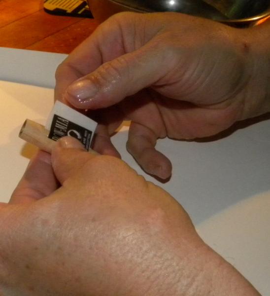

I have been busy making Decals----------here's a little trick I like.
I roll the Decal onto the pen instead of sliding it off the backing material.
I have sent a couple of samples out in the last couple of weeks to a few friends to try out and thought this might make things easier.
