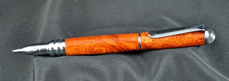

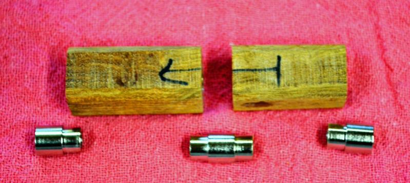

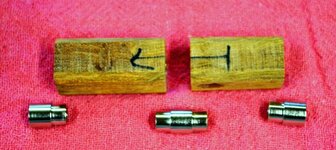

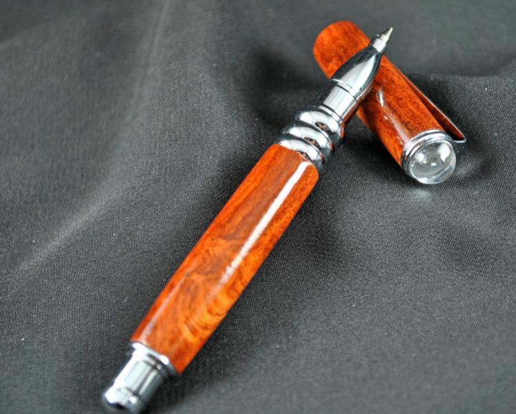

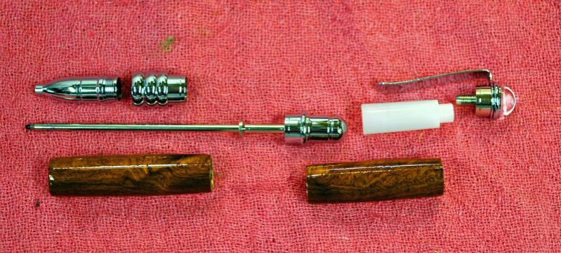

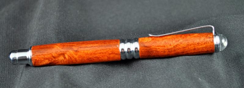

Pictures below:
1 - bushings and barrels
2 - turned barrels and all the parts
3 - completed pen - closed
4 - pen open
5 - posted cap
