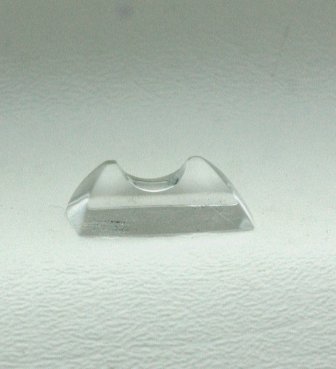

When taking pictures of pens I need to be able to hold the pen from rolling over. Since the weight of the clip tends to roll it over just as im taking the shot I decided to make a small stand to keep it in the position I wanted. I used a piece of 1/2 thick plexiglass 1in x 1in. square. I first drilled a 5/16 hole in the center of the 1 inch surface and then cut it in half. leaving me with 2 pieces 1/2 thick, 1/2 tall and 1inch long, with half of a hole in each piece. I used a sander to shape it roughly pyramid style and then sanded it down through the micromesh grits and hand polished it with a dremel/ foredom. This could easily be made with any 1/2 inch cut off of a 1inch sq blank. It is easily made and doesnt draw attention away from the pen.

Feel free to use it as you will. Thank you Jennifer and Paul.

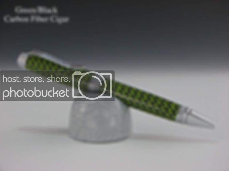

It appears that I am in the minority here, not that there's anything wrong with your stand. It appears to be more of a pillow than a stand.
I prefer to display pics of my pens in a standing up (more or less) position rather than lying down.

Hmmm the "PEN PILLOW" I like it, do you suppose theres an oppertunity here.
I've got first dibs on the name!:biggrin:I think there's a great opportunity here, by all the replies that like it.
