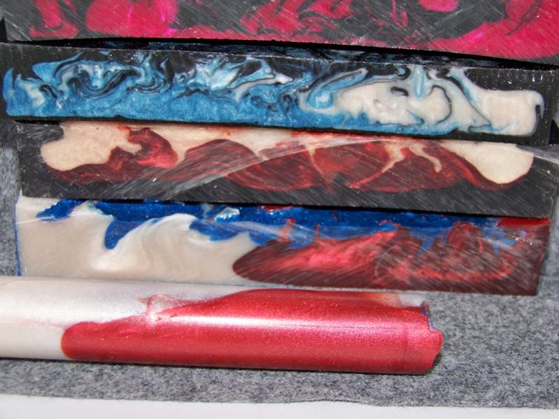

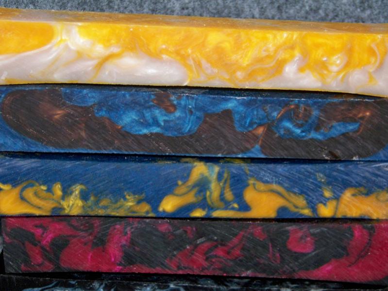

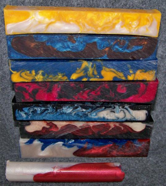

haven't posted any work as far as casting blanks lately. i've been filling orders and finally had a bit of time to make some for muah. here are the colors from top to bottom:
yellow/white
bright blue/chocolate brown
blue/yellow (blue angels)
black/magenta (for those looking at coastal scents mica this is what cellini red ends up like...not red at all)
black/white/silvery blue
black/red/white with a ton of gold flakes
red/white/blue (not happy with the blue, not enough swirl)
red/white/blue (tube blank...blue will be on the inside)
thanks for looking and for any comments

Wow, some nice combinations. I don't have the talent to try that yet. How do you get the separations of colors to be so prominent? I tried with alumilite and the colors just kind of blended.
best way i can explain is to mix each color separately/add catalyst and wait until they start to gel. not just when they start to thicken but when they are almost set. you have to be VERY careful about air bubbles with doing this. maybe its my turn to try a tutorial, but i'd have to do a video bc a picture can't show what i'm trying to explain.
