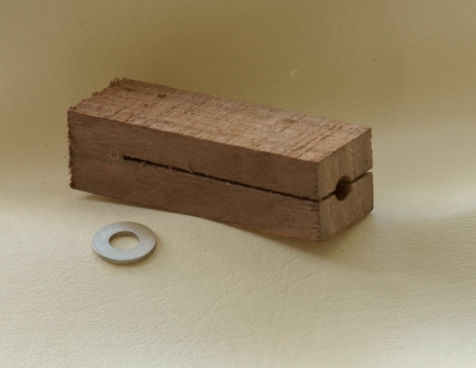

I ran across a slim I made many years ago and had set it aside because I pushed the transmission in to far.:rolleyes: I happened to also run across an article on the pen makers guild page http://www.penmakersguild.com/articles.htm
Under the article Mistakes by Rich Kleinhenz.
THis is a simple Jig made to remove or back out the Slim Line transmission if you push it in a little to far. I made one of a short pen blank piece of walnut. It measures apx 1x1x3in long. I drilled a 1/4in hole close to center and ran it through the bandsaw 2 1/4 deep.
slide the 1/4 washer on the pen, insert it into the jig leaving enough room to get 2 screwdrivers between the washer and jig.
Clamp it in your vise and gently pry the washer up.
As it says in the article leave your refill in place and you can do pry it out to just the length you want.
Hope this will help someone out. There are some great articles there you can browse through.
Mike

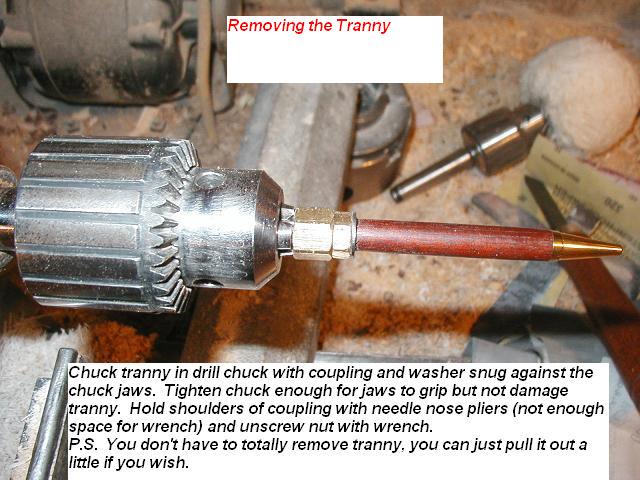

Suggestion for removing tranny from slim line pen.

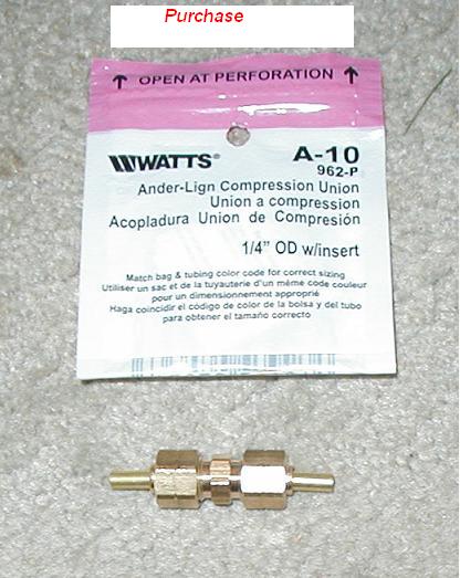

A. Purchase 1/4" compression coupling in plumbing aisle of home center.

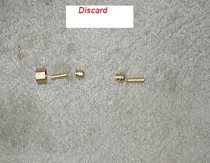

B. Remove and discard the compression rings and one of the nuts.

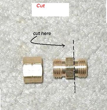

C. Cut off the threads on one end of the coupling. This is to make it short enough for the tranny to extend through it.

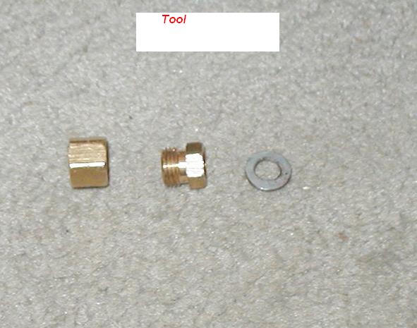

D. Drill out the center of a small washer to 7mm.
You should now have this.
E. Screw the nut onto the half coupling.
F. Slide the washer and coupling onto the tranny.
G. Chuck the tranny in your drill chuck.
H. While holding the coupling with a pair of needle nose pliers, unscrew the nut with a small wrench.
The expanding coupling and nut will extract the tranny from the pen.

Good. Let us know how it works for you. Works real well for me, no stress, no strain. Doesn't damage the pen barrel and if you are a little careful you can even reuse the tranny.
