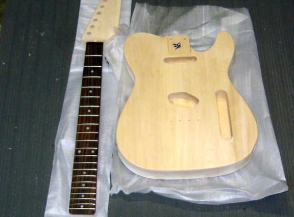

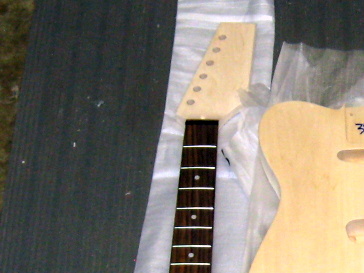

I am pretty excited about this ! I've wanted to do this since I was 13 years old . This is somewhere on my "Bucket List" Finally , I found the kit that fits the budget . A Fender Telecaster , unfinished but , routed for the pick-ups and wiring . I'll have to shape the head and , do some sanding with 600 -1000 grit . Ordered some Translucent Blue dye & Clearcoat for the finish . The frets look to be pretty level and smooth , so I'll put it together and see how it sounds , then see about leveling and crowning . I have upgraded the pick-ups and tuners as well as the bridge & ferrals for running the strings thru the body . I REALLY want to thank Cgris Leadbetter (Chriselle) for giving me some very important tips on doing this . If I get this put together , I hope to have Chris build an Amp for me . Wish me luck on this first guitar project ! :eek:

Sweet! Building a guitar is on my list too. And teles are my fav. I have owned 6 and still have my 1st. If u need any wiring help or pickup recommendations give me a shout

Well, looks like you are going to have a lot of support from other members here. What are you going to do for a nut? Also, I can't see in the picture but did they drill wiring channels from the neck pup route to the control cavity? Enjoy the build and let me know what kind of amp you're interested in..:wink::wink:
WHAT NUT ?? Yes , all the channels are drilled . The body is drilled for the bridge screws , and the neck is drilled for the neck to body screws . Thanks for the help Chris .

Looks to me like your nut is already installed. It is the piece at the transition of the headstock and the fretboard that has the slots in it that keep the strings in line.

I odered the kit from guitarfetish.com . They offer several different styles and woods . They recommend upgrading the components and , sell them on their site (which I did ) some of the good stuff (pick-ups) are on back order but can be found elsewhere . A word about this site . It is an online only business and , there is no telephone contacts . All correspondence is made by email . I am waiting for a response to my email . When I ordered my upgrade pick-ups , I received two bridge pick-ups although the invoice showed 1 bridge and 1 neck with chrome cap . Otherwise I'm happy so far . We will see .

Jump in there Bree ! I don't want to be the only one doing this . I have to say , this neck is maple (unfinished) with a rosewood fret board . I took it downtown to a Musicians Repair place to have it leveled and crowned . The guy said it doesn't need it :eek: , go ahead and put it together , try it out and , if there's any string buzzing , bring it back .

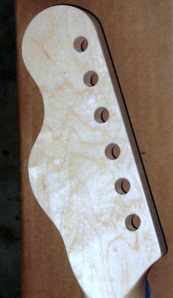

I'm gonna get started on it probably tomorrow . I have to start with the head . It comes squared at the top . I'll have to duplicate the Tele shape as close as I can and , cut out on my scrollsaw , then start sanding . After that , I need to drill the string holes thru the body . :eek: THAT will be a challenge for sure .:redface: I'll get pics up as I go .
Cut out a template from MDF. Get it properly shaped. Then cut your actual head using the template and flush trim router bit. That will give you the best result with the least sanding and chance for error... just like David Marks does!

This is a primative operation here . No routers , not even a bit . I'll see about a template . Thanks Bree , I'll be right over ! :biggrin:

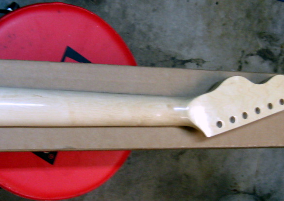

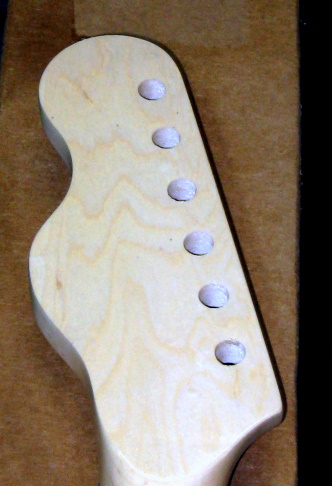

So here's what I got done today , after visiting my daughter for her birthday and , going to Lowes for supplies . The after market necks come in the paddle shape , so not to infringe on Fender trade marks . So I made up a shape similar to the original . I drew out a line , and cut close with my trusty 10" Bandsaw . Made it pretty easy . Took it to the Beltsander and got it closer . Then it was 320 by hand , followed by 600 dry . Right now it has two coats of Deft Laquer on it . I'll put two more on it . I made a temporary neck for handling the body as I'm coating it tomorrow after sanding .

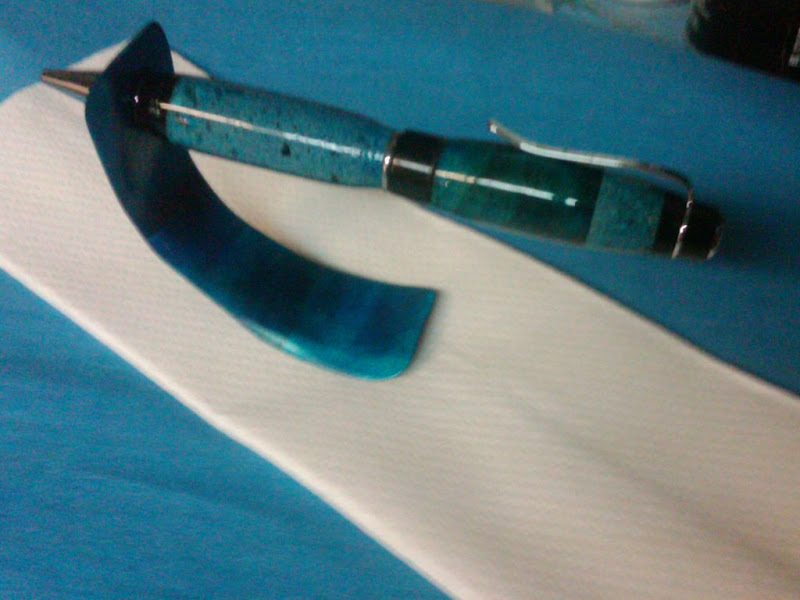

Blue dye
Blue food coloring makes a great translucent dye. Dyed buckeye burl and acrylic. The stand dyed curly maple. Excuse the quality.

Thanks Chris . One more coat of Laquer on the neck , then wet sand and polish . New bridge , pick-ups and string thru ferrals will be here Tuesday .

That is a nice shade of blue and , a nice pen . Already have the dye though . Thanks for the suggestion and , photos .

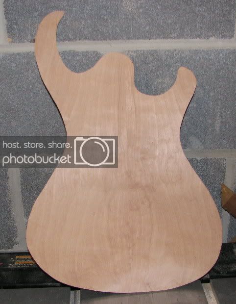

I started making the patterns for my first guitar today,I am not going to do the kit thing (may be a big mistake) luckily I have a strat i can take apart to make patterns and such.I would like to see your progress.Made the pattern for the body today,I think it turned out ok .
If you have tools for routing and drilling wire channels , cutting for frets and nut , then you're not making a mistake . I just chose the easiest direction for ME . :redface: I got the backside of the neck and head finished today . Have to get some Lemon oil for the Fretboard tomorrow .
Glad you decided to go for it Ronald . I'd like to see your progress too .
