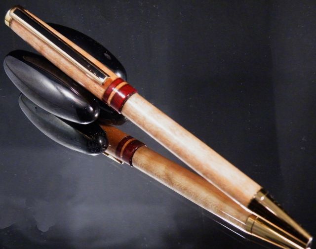

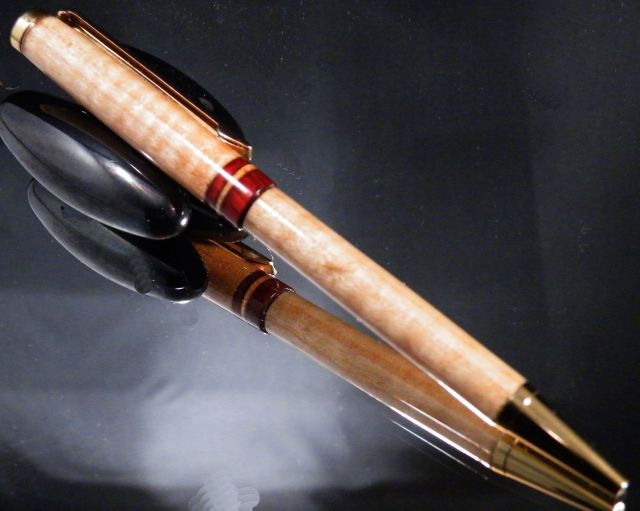

This is a modified slimline I made for the Penmakers Challenge . It is made with curly maple and a custom made centerband of pauduk . This entire pen was made on the lathe no saws were used to cut the blank or centerband .
Remember this is a Challenge so it's time to put on your thinking caps and figure out how it was done . I will answer all questions but you might not always like my answers :devil: I will be posting how I made this one at the end of stage 1 .
Sorry for the crappy pictures but I really couldn't bend very long to focus manually so I had to use the auto focus .
Now let's have some fun and and get some better pens posted .

Glue up the blanks on the tubes, trim the blanks, chuck up the cap end and turn round. Part off whatever distance you want your CB to be from the end, then glue on new parts. I use CA and clamp it to make sure the joint is solid. Trim up and turn to desired shape.

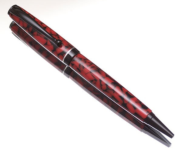

I would say that is close, but notice the extra maple between the layers of paduk in Butch's pen? To me getting that effect is the fun part. (ha, get it "part" :biggrin: ). Even more fun is getting the grain to match up. Here are some others I did that way.
Don , Thats kind of what I did but I used a thin slice of the parted maple as an accent . That was the hard part , parting off that thin slice of maple . The slice kept falling apart .
Thanks Hans . That is exactly the effect I was trying for . It's that little extra effort that sets it apart from just a one piece centerband . I could have used a piece of acrylic in there but the maple from the body ties it all together .
Don if you mean thin CA to hold the slice together then yes that's what I did . It hardened the wood enough to part it very thin . I also gave the upper blank a sealing coat of thin CA to seal it so the the Paduk sanding dust didn't get into the light colored maple .

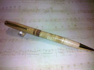

Well, lookee there, I learned something new on day 1:biggrin: Fairly simple design, but in the spirit of the challenge, no saw blade was used in the creation of the CB. Quitled Maple and Padauk, to stay true to the original pen. While this isn't the most impressive use of the technique, by figuring out how to build the CB on the lathe with no saw, it took a huge amount of the guesswork and "eyeballing" out of the rings and made them MUCH more accurate. This is something I will use quite a bit more, now that I know how to do it, in that it will allow me to do some more intricate stuff without sanding the tips of my fingers off getting things even:biggrin: My technique used delrin, CA, and a parting tool. Butch, I will be anxious to see what your technique was to accomplish this, and without spoiling the fun in the thread, I will be happy to answer any questions on the method I used through PM if anyone is interested. Thanks for looking.
Sorry about the crappy cell phone pics, my real camera is not with me at the moment, but will be back for round 2:rolleyes:
