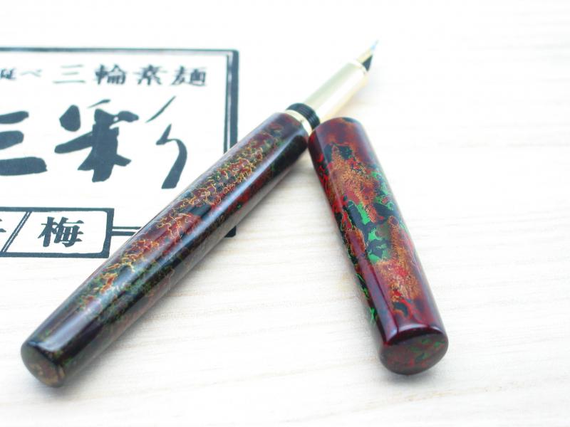

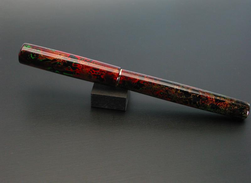

Just another couple of Urushi's. Both are hard maple base using hijacked Sedona bits. The nebula has umm...many layers....I lost count but there are more than 10 and less than 20 with a few gold dustings in there, too.

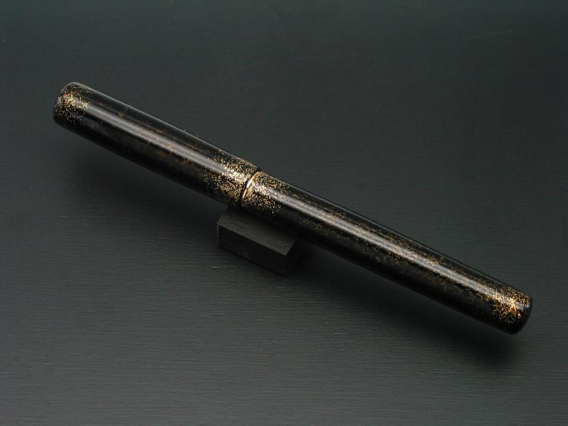

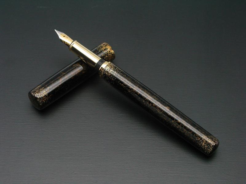

The 14K fire is 7 layers of black with two gold topped off with #9 gold kinpun sprinkled on the ends and middle.

I think that nebula pen is just incredible. It has the old "psychedelic" look to it. Both are fantastic. As usual.

Dude, those are excellent, as always. Great fit and the finish is amazing. I was a little undecided on the "penny" pen, but I gotta say, on these, my opinion comes down on the "don't really want to see the gold band breaking up that amazing finish" side. Of course since I'm not standing in your store with at least 50,000 yen in my hand, my opinion is of limited importance :-)

Those are Awesome pens Chris, I love the Nebula, but can't that finish kill you??
Well, actually yes, it could kill you if you were hypersensitive to it but usually its just a nasty rash. You don't want to get any of it on ya.

Chris ~ gorgeous no runners up for the "ugly" pen contest!!
Love the look, dont know what it is..LOL
Toni, pure gold powders come in different sizes; the larger the number, the bigger the granules. The finer powders are brushed on just like dusting for fingerprints. The larger granular powders are sprinkled using small sieve tubes.

James...ya, the next group will probably have the ring hidden. I make these barrels in batches of 6 to 10 pens at a time and the decision to hide the band must be made at the time of drilling. There are so many options and things to try. I just wish the process didn't take so damn long.
