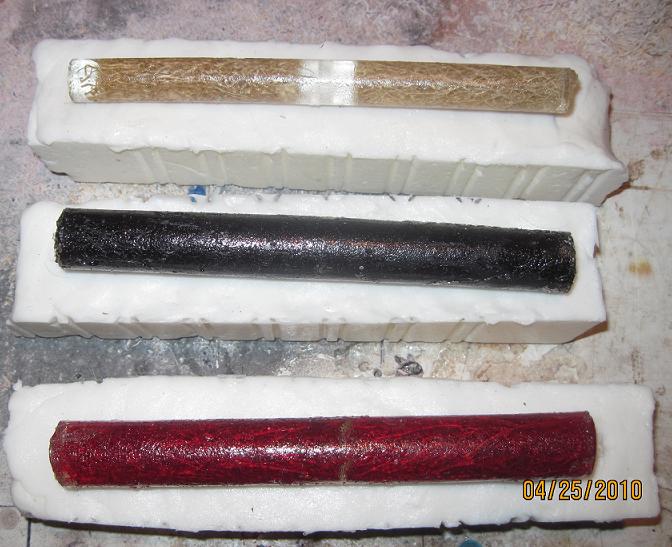

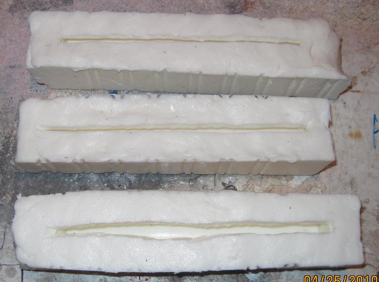

Here they are with the very first blanks cooling inside! They work ALOT better than what i was getting from the PVC technique with my cactus.
Looking forward to seeing what the final results are. The Cactus rounds were great to start with. These should be awesome.
They look like little pillows for your blanks.. :biggrin:
As promised. The new, Improved, Horizontal round molds. Allthough the finished blank is more of a keyway shape with the key installed.
The blanks are all cactus blanks. The two colored ones are part of a special order. They were really fun to make!

Nice...
Have you had the opportunity to turn one yet?
What's the clear spot in the middle (is that just the pic)?
I have one from the second pour that is drilled, painted, and glued. I am waiting for the glue to dry and i will turn it.
I am guessing you are talking about the top blank when you ask about the clear spot?
That is a section in the middle of the blank that has no cactus. The blanks are at or over 6 inches long, and not all the cactus is big enough to make a solid cactus blank. So, considering most of the pens we make are two piece bodies, I make some of the blanks two piece, meaning you cut it in the clear section, and turn the excess clear spot away. Then you have two half blanks that are perfect for a Euro, or slim, or whatever other two piece pen you are making!
Cool. Yes, the top blank. - Thanks.
Looking forward to the turned results.
Dude, Lovin' the cactus... :smile:
Dummy question of the day:bulgy-eyes:, are the molds flexible? I would assume so if you are able to get them out of the mold...what material is it?
They are made from acetic cure silicone. They are VERY flexible! I can even get a rolled up cactus to fit from end to end.
The small mold makes a blank that is 6" long by just over 9/16.
The big mold is 6" long, and just over 3/4 in diameter.

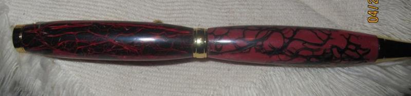

this is a finished product. Normally i would put another 10 or so coats of CA, but i was in a hurry, so this pen only got 5 or so coats.
