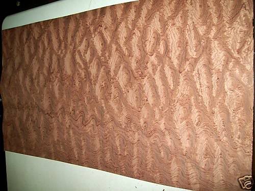

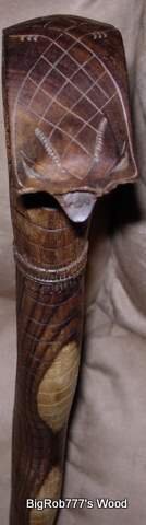

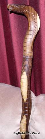

Oh, by the way, can we get a closer look at you natural looking cane?
Glenn,
I quit doing stomach exercises, once I got a 6" rip in my gut. It came from doing crunches after having lap band surgery.
I got my cane from a shop at the beach in Delaware. It was one of those places that make sure that the artisans get decent pay. I can't recall if it was from Africa, or South America and as much as I hate to admit it, I don't know what the wood is. It looks like some really good Bolivian Rosewood, but I'm extremely allergic to that. I love the way the sapwood is used to accentuate the belly and the curve of the cobra's body. Here are a couple of pics for you.
Click on these thumbnails:
