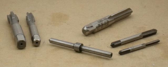

OK, lets look at a couple of taps. These are not anything special with regards to spiral flutes or even for special purposes. Just general purpose taps.
In the first pic (DifTaps.jpg) there is one very obvious difference between them. They have different names depending on where you live, but basically they are named after the amount of taper on the front.
You can see that the one on the left has very little taper. In fact this tap requires only about one or two turns to fully form the threads.
This is often the type of tap you will get in a Pound Shop ( Dollar Store )
But they do have a purpose. They are often called Bottom Taps, because they are used to thread to the bottom of a blind hole. The are also called 3rd cut taps, because if you need to thread to the bottom of a hole, it would be the third tap you use.
You shouldn't even attempt to start a thread with this kind of tap. You can be pretty sure that you will either strip the threads as you try or just break the workpiece.
Next tap has more taper, probably around 4 -5 turns before a thread is fully formed. These are pretty good taps and most of mine are like this.
They are often called Plug Taps or 2nd Cut Taps. These are not ideal for brittle stuff like PR, but can be used.
Next is my favourite. The long taper on these means that it is taking smaller bites out of the workpiece and needs several turns to form each thread. Because the thread is cut so gradually, they are ideal for our pen making purposes. Infinitely less stress on the work as the threads are cut.

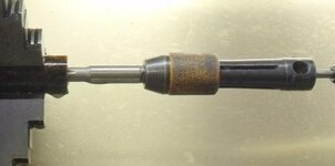

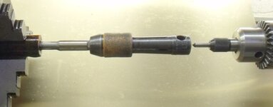

Next pic is a great little tool. It's called a Tapping Guide. (TapGuide.jpg)They are very cheap. It really is only a spring loaded pin. It keeps forward pressure on the tap while it enters the work but also keeps the tap aligned with the centre of the hole being tapped.
Next pic is the same tool but dismantled. (TapGuideDis.jpg)The pin can be reversed for different taps.
Next is the pin on its own with various taps. IMHO all good taps have a little hole in the end. Now you know why. The pin has a small hole in the end to guide taps that have a point on the end, but I have never seen points on anything but the smallest taps. The tap in the middle is chamfered on the end and I have searched high and low to find a Tap Guide that can take it. Pretty useless if your lathe bed is short.
Next is just a selection of my tap wrenches. With the exception of the T-Bar one in the front, can you spot what they all have in common??:wink:
You got it!!! They all have a little hole in the end. Mmmmm, I wonder why?:biggrin:

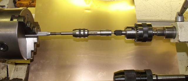

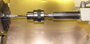

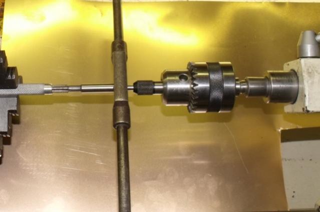

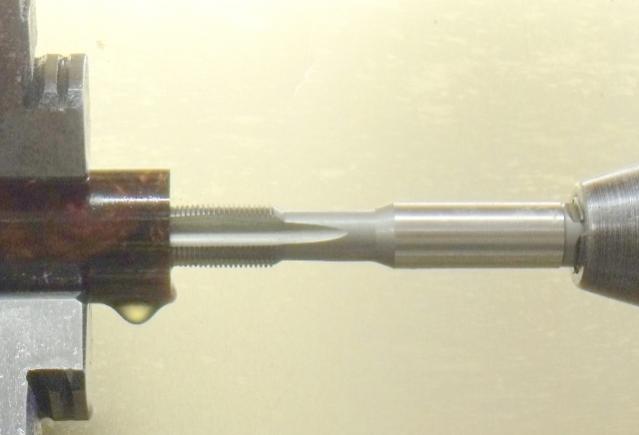

There a many ways to hold a tap in a lathe. (Important to remember is that the lathe is only used to keep everything aligned steadily. Of course the lathe MUST be switched off and preferably unplugged!!)
This is often determined by the length of your lathe bed. Do you remember when everyone kept saying to get the longest one you could afford?:wink:
My prefered method is with the T-Bar wrench. Don't worry if the T-bar is longer than the swing of your lathe. Just hold the wrench and rotate the work. :wink:
If you are stuck for space or don't have the wrench or tap guide, then you may be able to fully extend your tailstock so far that the little key dissengages and allows the shaft to rotate freely. This works well but has a couple of drawbacks. You have to re-align the keyway to get the spindle back in. And when you are re-winding the tap, it is easy to rip the first few threads out. But easy if you are careful.

Larry, those are neat little tools and great if you have the bed length. But they are over 6 inches long and IINM, they can only handle a small tap (upto M5?) I don't know what size #0 to #12 is. Do you know if they are made with a morse taper instead of having to be held in a chuck?

Good info Skip;
The hole in the end: If you can see thru the center of the tap end to end, it is for coolant/lube to keep the tap flushed out when power tapping on a milling station.
If it is just a dimple it was used to turn the tap between centers.
OOPS; Added later; You can often find a set of three taps of the same thread. a tapered tap to use first or if doing a through hole, a (mind blown - not sure of the term) tap to use next on a blind hole, and a bottom or finishing tap to finish off a blind hole.

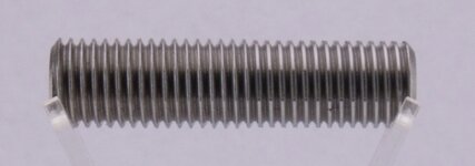

Lets get back to our ½ inch nut and bolt. Lets assume that we agree that either the bolt needs to be slightly smaller than the nut or vice versa or even both.
Have a look at the first pic ,( tomorrow ) this threaded rod has Vee grooves. The nut also has Vee grooves. Lets call the zigzag surfaces of both of them, the Diameters. There are of course two diameters for each ( major and minor) but lets just count the surface of the zigzags as the diameters for now.
The difference in the diameters of the nut and bolt will determine the class of fit.
Most often we prefer this difference to be as small as possible but still be practical.
Lets get back to the zigzags. If the vee grooves were absolutely sharp at their peaks and roots ( bottom of the groove) it would cause us lots of problems.
The edges would be sharp and cut us, they would be fragile like any fine point and possibly break off and jam in the thread, there would be no place for the dirt etc etc.
It would also make the cutting tools ( taps, dies etc ) extremely expensive to make and render them useless after one or two uses.
Sharp points also serve no purpose as the sides of the vees are the surfaces that do the work.
So we can get rid of the points. This will make them easier to manufacture and less likely to fail. I reality, when we use taps and dies, these peaks and roots are somewhat rounded. There are very specific and exacting dimensional standards set for these rounded parts but this has nothing to do with us.
It might be interesting to note that the peaks are more rounded than the roots.
Can you think why?

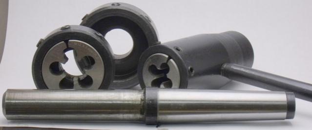

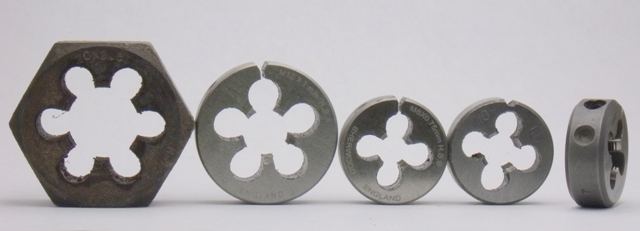

Taps and dies are designed to remove these useless points by the points of the bottom of the groove in the cutter, but they need effort or force.
Let's say that instead of actually 'removing' or 'rounding over' of the peaks on the threaded rod, we simply reduced the original diameter of the unthreaded rod?
How would this help pen makers?
Easy!! It would mean that only the tips of the cutting edges of the die would be applying force to our fragile material. Less force = less breakage. This would leave a flat topped peak.
Let's do the same with the nut. Instead of removing the peaks with the cutter ( tap), we increase the size of the hole that would accept the tap. Now only the tips of the tap are removing material. Less force = less breakage.
Theoretically, we could reduce the diameter of the rod and increase the diameter of the hole in the nut until we had only 1% of the vee surfaces touching. This would make it incredibly easy to threaded just about anything but not too practical.

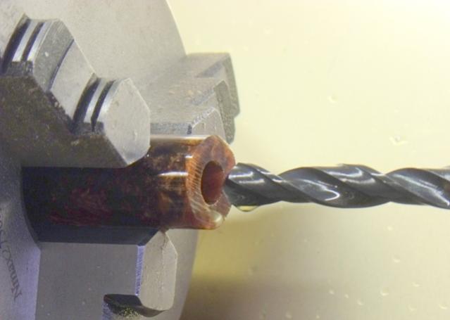

A 12mm x 1.75mm tapped hole requires a hole of 10.25mm ( 12 minus 1.75) to give us a 65-70% percent surface contact between the parts.
But if we increased the drill size from 10.25mm to say 10.5mm we'd still have plenty of material to take the threads but the force on the material from the cutting action would be greatly reduced.
Similarly, a 12mm x 1.75mm die cut thread requires a 12mm shaft, but if we reduce this to 11.75mm before we attacked it with the die, then threading it would be far easier.
The only difference is that our newly cut threads have flat tops instead of rounded ones.
Once we polish and buff them, they will be rounded again.
So, very long story short ( sorry) ……if your material is cracking when you tap it, then increase the size of the drill.
If your material is chipping or breaking while using a die, then reduce the diameter of the material..

The first one shows a perfectly formed thread on a piece of rod. The size is not important. What is important is the finished shape of the threads.
On the left side, the peaks are pretty sharp. Not absolutely sharp, but reasonably. These peaks are formed by the bottom of the Vee in the die.
As we used the entire cutting edge of the die, we can safely say that the thread was 100% formed. If we had painted the surface of the shaft before threading, then there would be no paint visible afterwards.
Now look at the right hand side. This end of the rod was turned to a smaller diameter and therefore only a part of the cutting edge of the die was used to cut the thread. This leaves a small surface (Flot top) that was untouched and would still have paint on it.
Let's assume that the section on the left was turned absolutely perfect and the die did not have to remove any extra material. Now, depending on the material and the condition of the die, a certain amount of force is needed for the die to do it's work. Let's give this a number but without getting into technical jargon like Newtons or torque.
Lets just call it '10'
The section of thread on the right only needed 'some' of this force as the die only did 'some' of the work. You can judge for yourself from the pic, but I'd give this a '7'. This means we subjected the material to 30% less stress or force. With fragile material, this is often more than enough for the difference between breaking and not breaking.
If we reduce the '7' to say a '3' then like you correctly pointed out, it would look crappy. It's a compromise.
Next pic includes some nuts, one of which I cut in half to show the threads a bit clearer. Believe it or not, these are both very close fitting machined nuts. There is virtually no movement on their corresponding bolts. But look at the tip of the Vees, they are flat. I promise I did not alter them at all.
Like the die in the example above, this means that the tap used to make them also didn't use it's entire cutting edge to make the thread.
As internal threads are hardly visible, this is where we can get the most advantage. We could easily reduce that '10' to a '5' and thus half the amount of effort required. Less force on the workpiece = less breakage.
So, if we start at '10' and things break, then move to '9' and so on till things don't break but the resulting 'look' is still acceptable.
If we can't get rid of the breakage until we have unacceptable results,(find the compromise) then we'd need to find an alternative or stick to kits:biggrin:

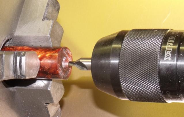

OK, the first thing we obviously need to tap a hole is to drill the hole.
If you haven't already got centre drilled holes that you used to make the blank round, then this is the first step. (Pic; Centredrill.jpg)
I don't step up in drill sizes to get to a final size, but just use the one I want directly after the centre drill. (pic;drill.jpg)
A little tip here; even if you have centre drilled or previously drilled a smaller hole, then advance the bit extremely slowly. You may see that just one of the cutting edges is removing material. Just let this one edge do it's stuff until the sides of the drill are actually in the hole. At this point the 'lands' take over and help keep the drill running true. The lands are the ridges that spiral around the outside of the drill bit.

Next pic (taper.jpg) shows the tap in the hole and ready to cut threads.
Note that it is halfway up the taper before we have started. This hole could be a tiny bit too big. But we don't want to crack the PR. We'll see.
After taking tiny back and forth turns slowly advance the tap until the thread is cut. Use lots of lube. You can use anything you like, but I prefer soapy water in a squeezy bottle. I just have to clean up everything when I'm finish to prevent rust.
If you use one of the spring loaded tapping guides method then don't let the next pic happen to you. You can see that I got carried away with the threading but forgot to advance the tailstock. Likewise, don't forget to retract the TS when removing the tap. There isn't a lot of travel in the spring. (pic; ooops.jpg)
Next pic shows the tap deep enough for my needs. ( pic;deepenough.jpg)
If you use a taper tap, then you need to check how deep you need to go to ensure you have enough full threads in the hole.
Last pic is the finished tapped hole. Perhaps I was a little too cautious in my drill selection. This hole is probably a '5' ( see previous explanation)
But as it's an unseen internal thread and also a snug close fit, it's fine.

OK, dies. Just like taps, they come in a variety of types and shapes. I also think they have greater range in quality, unfortunately towards the bad side. They are more expensive than taps, mainly ( I believe ) because external threads are easy to do on a metal lathe with a single point cutter. This means there is less demand and so the price shoots up.
I think this could be the reason that there are more crappy ones available than good ones. Most dies from cheap sets couldn't cut threads in butter and should only be used to 'repair' a dinged thread, like a stud on an engine block. This is an example of where the hexagonal shaped ones are really useful.
As the first pic shows ( dies.jpg) , they come in different styles. The don't have as many types for special forms like taps do. They all seem to be basically the same.
The best ones are called 'Split Dies' , obviously because they have a split through one side. This split is so that we can get a tiny amount of adjustment on the depth of the cut. I don't think that most 'hobby people' will need to use this feature. The adjustment is done by three screws in the holder. Next we have the 'Dollar Store' variety( second from the right). I hate these with a passion. They don't have a split so they are easy to spot. In my opinion, they should only be used for thread cleaning like the hex ones. The one on the far right is weird but reasonably good quality.
It has a tiny screw that is used to adjust the cut but it works backwards to the norm. :confused: The split type are at their biggest size when relaxed and the screws in the holder squeeze it down if needed. But this one expands to final size by adjusting the screw. The problem is you need to remove it from the holder to adjust. And if you didn't 'stretch' it in the beginning then your thread could be too small, which of course you can't reverse.
Weird, but it cuts fine though.
Next gadget is a Tailstock Die Holder. ( pic; dieholder.jpg) They come in many different styles but I really like mine. It comes with holders for different diameter dies and has a morse taper to fit in the tailstock.
The holder part slides along and revolves freely around a sturdy shaft.
The individual holders have three screws. These match with the dies
The middle screw fits into the 'split' of the die and the other two screws are for adjusting the die. The three screws together, stop the die from rotating in the holder. These are very cheap for what they are.

Hi Mate one thing I find is to do away with one of your stages tapping I fit the live centre up to the cutter end takes another wobble out and control the feed pressure with the tail stock wheel. I delight in yourtaking time out to help people on this site, it requires time and effort to simplify processes.
