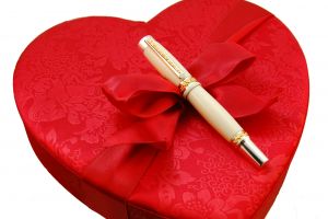

PenMan1 Member Joined Jul 8, 2009 Messages 6,380 Location Eatonton, Georgia Mar 16, 2010 #1 This is a way that I have found to cover the black plastic ring on the Cambridge Ultra. The black plastic just looks goofy.

randyrls Member Joined Feb 2, 2006 Messages 5,241 Location Harrisburg, PA 17112 Mar 16, 2010 #2 That is excellent! you covered it with a scrap of pen material? or did you turn it off and replace it?

PenMan1 Member Joined Jul 8, 2009 Messages 6,380 Location Eatonton, Georgia Mar 16, 2010 #3 I cut down the plastic ring, then turned the casein ring and epoxy glued it to the ring.
P Phunky_2003 Member Joined May 18, 2009 Messages 1,470 Location Bonham Texas Mar 16, 2010 #4 wow thats a beauty!! James
J JimMc7 Member Joined May 12, 2009 Messages 730 Location NE Oklahoma Mar 16, 2010 #5 Good idea and great looking pen! Nice looking kits w/o that clunky black ring.
broitblat Member Joined Feb 9, 2006 Messages 3,225 Location Bellevue, WA, USA. Mar 16, 2010 #6 I really like the looks of what you've done -- looks like it belongs there. -Barry
OKLAHOMAN Member Joined May 17, 2006 Messages 10,228 Location Costa Rica Mar 16, 2010 #7 The casein with the ring and that pen are a super match, I like very much.
P PaulSF Member Joined Oct 9, 2009 Messages 286 Location San Francisco Mar 16, 2010 #8 Glad you posted this! I was just thinking about how the black plastic ring ruins the look of the pen.
Jim15 Member Joined Dec 20, 2005 Messages 21,688 Location Hamilton, Ohio, USA. Mar 16, 2010 #9 I really like it, great thinking.
