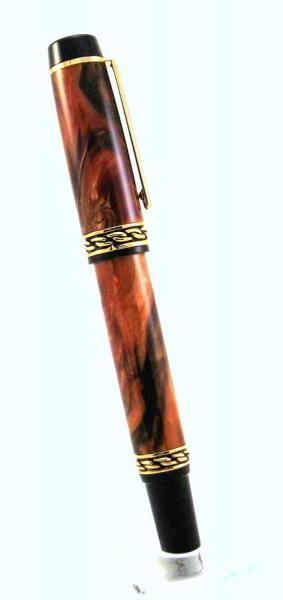

I turned an Olympian Elite 2 this morning out of Exotic Blank's Burnt Copper. I have been pretty much converted to tbc since George's excellent article. I, so far, use the stock pen kit bushings. As I was almost turned down to the bushings I noticed things didn't appear to be ROUND!:eek:
When I removed the blank to check it with calipers I noticed the bushing had some dried ca on it. After scraping the bushing clean, I took time to sand the ends of the blank with a converted barrel trimmer and then remounted the blank. I could feel how out-of-round the blank was as I turned it down. I can see why johnnycnc's bushings are so popular! :biggrin:
Just wish I had paid attention to the fact that the two bushings on the cap end were different sizes ... lost my center match. :redface:
If we learn by our mistakes ... I'm learning something everyday! :smile:
