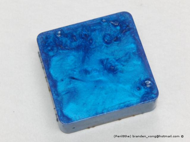

Hi All,
My first attempt to add some colours to my PR blanks.
The original plan was to have 4 separate cups of PR (2 oz. each) because I just made an 8 oz silicone mold.
I was supposed to add the colour (PealEx) in each of the clear plastic cup. Then stir in the correct amount of PR accelerator. Wait for 20 - 30 minutes when the PR starts to "gel". So I can pour the "gelled" PR into different part of the mold, then use something like to toothpick to make some pattern/swirls.
BUT, after 10 minutes I went to check the PR, all the plastic cups were leaking. Lucky I had line the work area with newspaper.
So I had to hurry to pour all the remaining PR from each cup into a smaller 3 oz. mold and scrape up the spilled PR.
And this is the end result. Not bad for a mishap which I am very happy about.

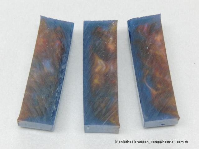

Now I wished I just had the two blue PearlEx as shown in the 2nd picture which is the bottom view of the slab.
It is getting late. I think I am going to make a pen from middle blank tomorrow.
P.S. Not sure why the cups were leaking at this time, but I am taking RAdams's advice to get some silicone muffin pan (http://www.penturners.org/forum/showthread.php?t=58853)
Picture 1 - top view
Picture 2 - bottom view

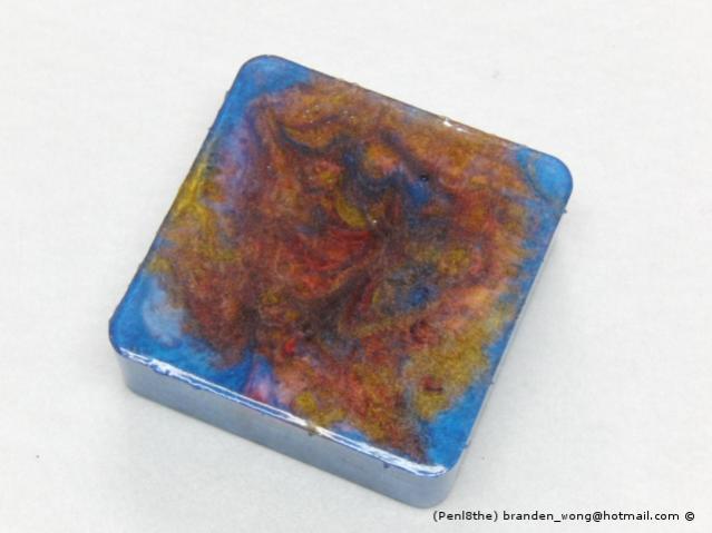

Picture 3 - cut into blanks
