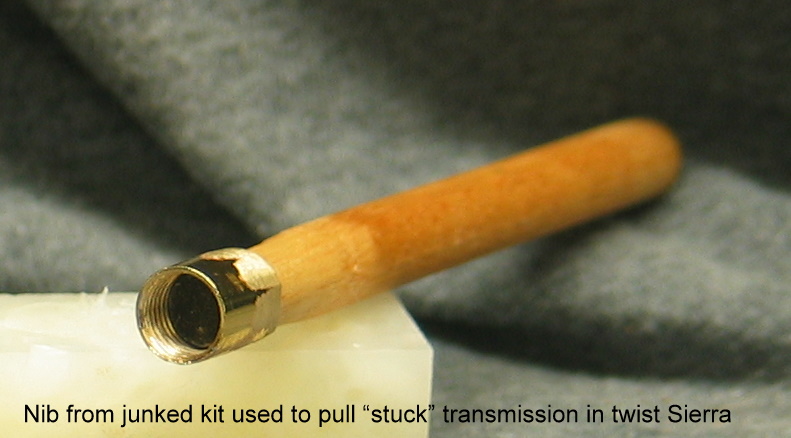

<snip> just turn off or remove the trim ring and turn down the part that inserts into the tube. Reach inside and grab the threads.<snip>
+1

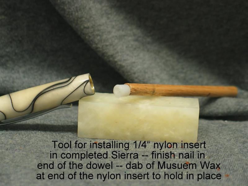

Here's a tool made for purpose Randy describes. Nib thread portion from a junked kit and epoxied on a dowel.
Also, as others mention, you can prevent the problem by epoxying 1/4" dowel in the cap before assembly. I use the 1/4" nylon spacers from Lowes and epoxy if a new pen or use museum wax to hold it in place if a completed pen. You can then tell customers to unscrew the lower 1/3 to change the refill w/o worries about the transmission sticking out of reach.
