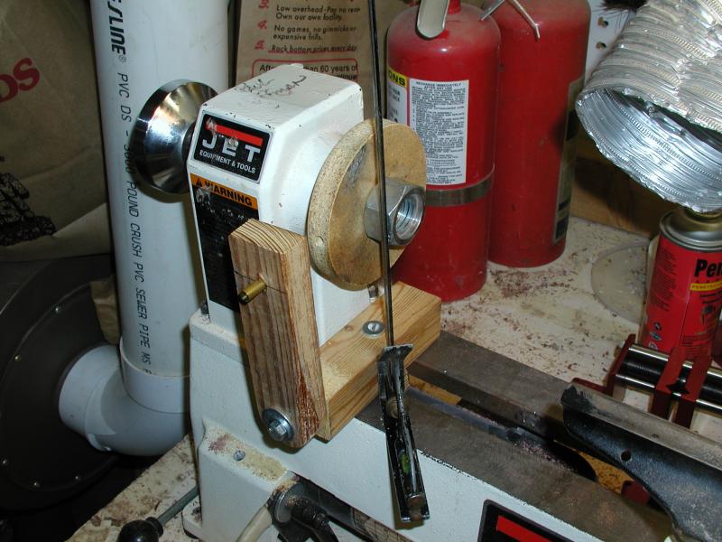

See if I can get these pics to work. One is made from a 1"-8 nut welded to a sprocket. The other shows one I started using a nut to index, and a piece of mdf for the wheel.

Thanks for all the help everyone!! Lots of awesome ideas! I am sure i can get something figured out from all the tips and pics and links! Once again, IAP IS the spot for knowledge!!!
P.S. Paul, You my friend, are a GENIUS! I really like both of your ideas! I think the sprocket idea could be a really really good thing for my needs! And the bolt and MDF will be a good system to hold me over till i can find a sprocket and such. thanks for the pics! Wish the second was bigger so i could see the pin part, but i am sure i can figure something out! thank you for taking the time to share!
