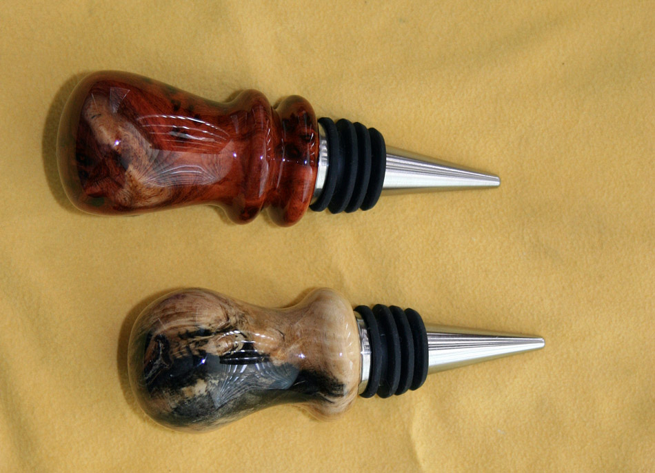

After turning my first stoppers and really liking the raw natural wood look and feel, I thought it would be best to put a finish on them considering how they will be used. I was very please with how well they finished.
These both sold to the first people I showed them to and I have requests for more, which was a little surprising to me. In the process of showing the stoppers, I also had the oppertunity to sell a few pens. It's turned out to be a very profitable day for me.

Those are gorgeous, Dave!!
I'm glad you are having luck selling them. All the wine drinkers around me looked at mine and said "those are really nice. But we never have partial bottles left so we don't need stoppers". :rolleyes:
