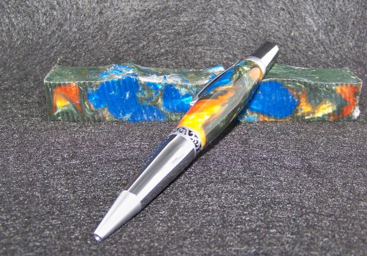

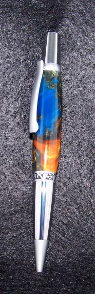

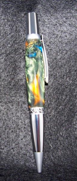

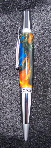

Made up these blanks last night. I've named this batch "Earthbound". This is the first one HOT off the lathe. I am VERY pleased with the outcome. I used castin craft PR with some metallic mica powders. MM to 12000 and finished with PlastX and topped with Ren Wax. As always any comments/questions appreciated!

Beautiful pen. Great casting. The Sierra Elegant pen kit is a perfect match with the blank.

Sure thing Branden. I'm also very new to casting myself, I think this is only my 3rd batch I've made up to date. As far as the PR goes, The Castin Craft PR is a 1 part mix where you can add your powders or dyes either before or after you add your hardener. Since the hardener doesn't add any volume to your mix it doesn't dillute anything. I do however add any of my powders or dyes BEFORE adding hardener because I want to have enough playtime to adjust how much powder and make sure I have what I want before it sets up (Which it will before you realize it). I added 3 drops of hardener per oz. of resin. I want to say it took about 20-30 mins for the resin to thicken. Once I have the resin starting to gel I make my pours into my mold alternating colors for a nice mix, also I run a toothpick and swirl things around a bit too. Then stick it in the toaster oven (TURNED OFF) overnight to help with the fumes (respirator is a very smart thing to use by the way). I check them in the morning and if they are still tacky I'll turn on the toaster oven on 150 for about an hour. Hope this helps and ask anything else that I might not have covered. Also, I'm no expert with this so please use this as a helping hand and not a must do list. experiment with things for what will work best for you. Oh yeah I almost forgot...this stuff STINKS!!!! :tongue:
I'm so impressed with how your blanks turned out! The metallic sheen really shines in each of the three colors and I love how you were able to almost segment each color so that they blend just at the edges. Really phenomenal work! Your pen is so much better made than mine and a wonderful finish. It looks made of glass its so smooth! Excellent job and I want one of your blanks. :)
Great Job, especially for being your third pour! I think your on to something and can see this being a seller for you. Hope you keep pouring! lol
