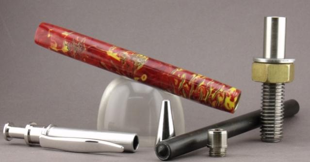

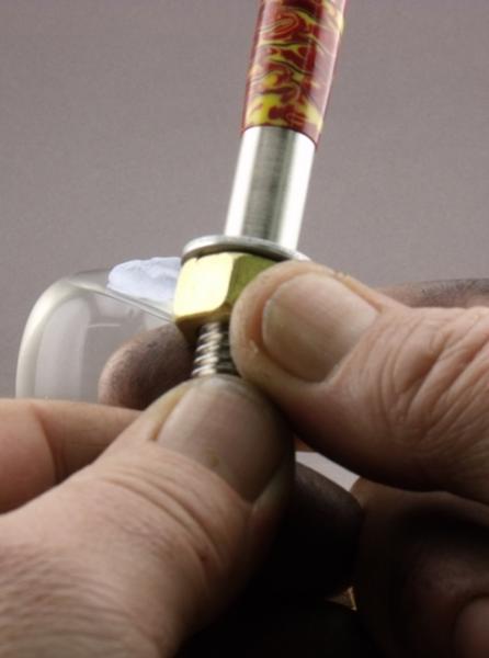

Here is a little tool for dismantling the front end of a Long Click pen.

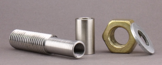

It consists simply of a 12mm stainless steel thread that has been drilled and tapped to fit the threads on the nib coupler.
Although a seperate piece could be made, I chose to use the assembly sleeve that comes with each kit. A section of the thread was turned off to fit inside the sleeve.

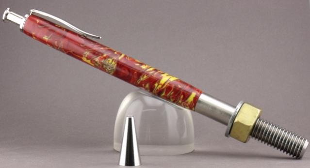

The procedure I use is;
1.Unscrew the nib and remove the refill.
2. Assemble the screw with 12mm nut,10mm washer and the sleeve.
3. Screw the assembly onto the coupler. Just so it bottoms out, not tight.

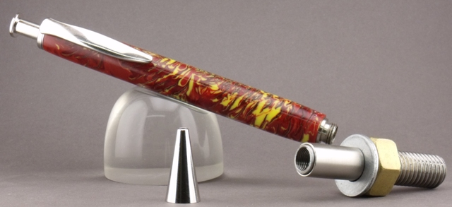

4. Hold the thread in one hand and turn the nut with the other. If it is too tight for hands then hold the thread in a chuck and use a spanner if needed. I managed by hand, but I do have strong fingers.

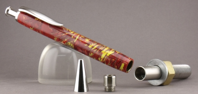

5. The coupler pulls out. Unscrew it from the tool.

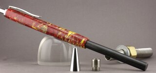

6. Now you can use a full sized drift or transfer punch to knock out the mechanism. Do this over a cloth so you don't lose it or it gets scratched by hitting something. I use a Letter R punch.
They are easy to make and I'm thinking of making a bunch to give away.
What I was thinking of is to make say 10 of them and give them to the IAP chapter that has the most entries in the Bash Pen Contests. This way I only have to pay postage once and the Chapter spokesman can dish them out as he/she sees fit. ( if they want them of course ):biggrin:
I'll check with Cav if I'm not breaking any rules before confirming though.:wink:

Skippy I have been working on a very similar project but lack the tools and the skills you have to make such an elegant device. Thank you
I discovered that using the assembly tool for disassembly has some problems. For the process you outlined as I understand it the assembly tool will apply counter pressure directly onto the wood or acrylic wrapped around the copper tube. In doing this i have actually had my wood blank fail and collapse around tube near the nib section destroying my pen. Not sure if this was a gluing issue or a materials issue.
Have you had this issue at all?
I will PM you with my thoughts on a new approach
Manny
skiprat
Passed Away Mar 22, 2022
In Memoriam
Oct 19, 2006
7,812
In a Skip in Wales
Manny, there needs to be a point to bear against and the use of the sleeve does two things. First it presses against the blank ( obviously:rolleyes: ) but it's primary use is for it to be stationary ( stationery, stationry? ) while the nut is turned. If I had used just a long nut or threaded sleeve instead of the kit sleeve and washer, then the force would not only be pressing but twisting against the blank. I figured that 'could' damage a really soft blank.
I did think about making it screw onto the coupler and then have a long thin threaded rod down the middle to press against the mech. One of them would come out first and the other could be punched out.
The problem with that is that anything that could fit inside the coupler would also fit inside the mech.
As this would ( hopefully ) be very rarely used, it didn't seem worth the effort to make anything any more complex.
But please send me, or post here what your idea is. I'm sure any design can be improved upon. LOL, even mine:redface::biggrin:
