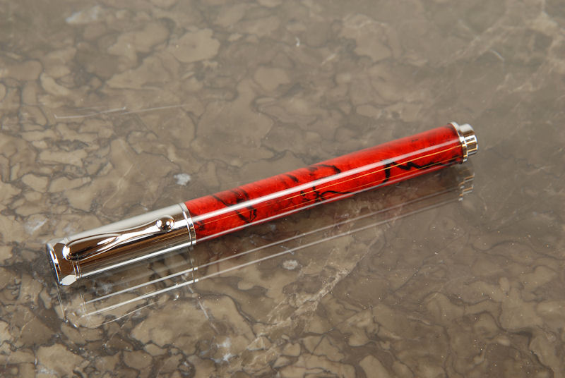

This was my first time working with stabilized pen blanks. I got them from Exotic Blanks. Very different to turning regular wood blanks, but I was impressed and can see myself turning stabilized wood on a more regular basis. The blanks all drilled and turned great, and I was deliberately being aggressive when turning. The one that impressed me the most was the spalted hackberry. Not only was it crosscut, but it also had the pith going through it. Without stabilization I'm sure it would have been a bear to turn!
After turning them down to size I dyed them using TransTint dyes.
  • Zen - Dyed red Splated Hackberry

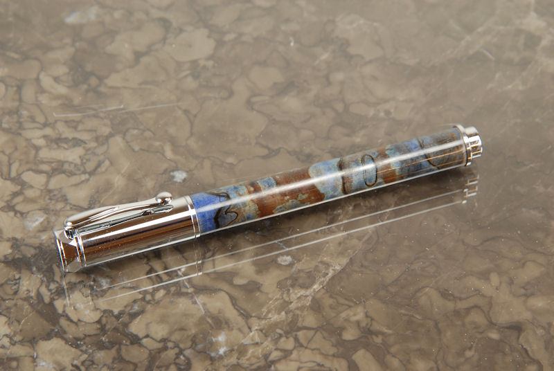

  • Zen - Dyed blue Spalted Crabapple

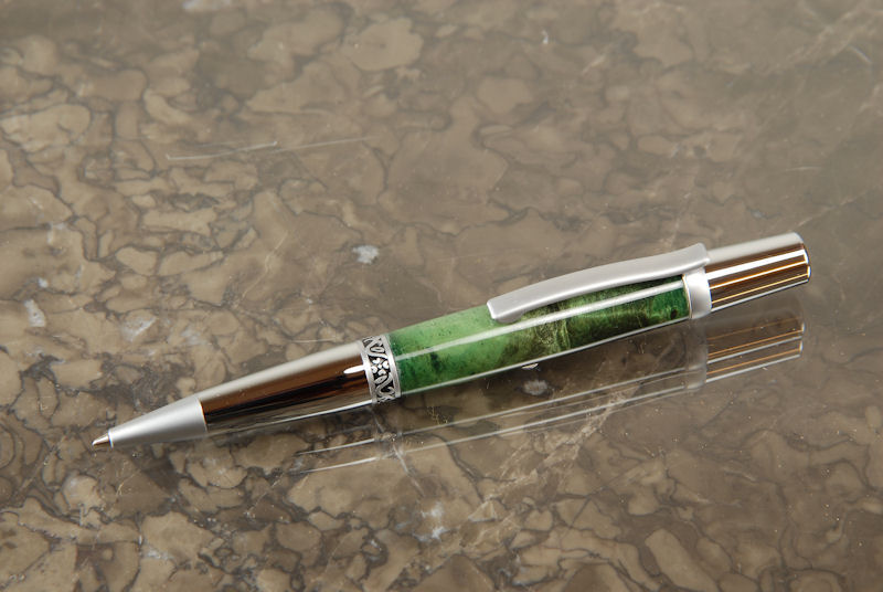

  • Elegant Sierra - Dyed green Box Elder Burl

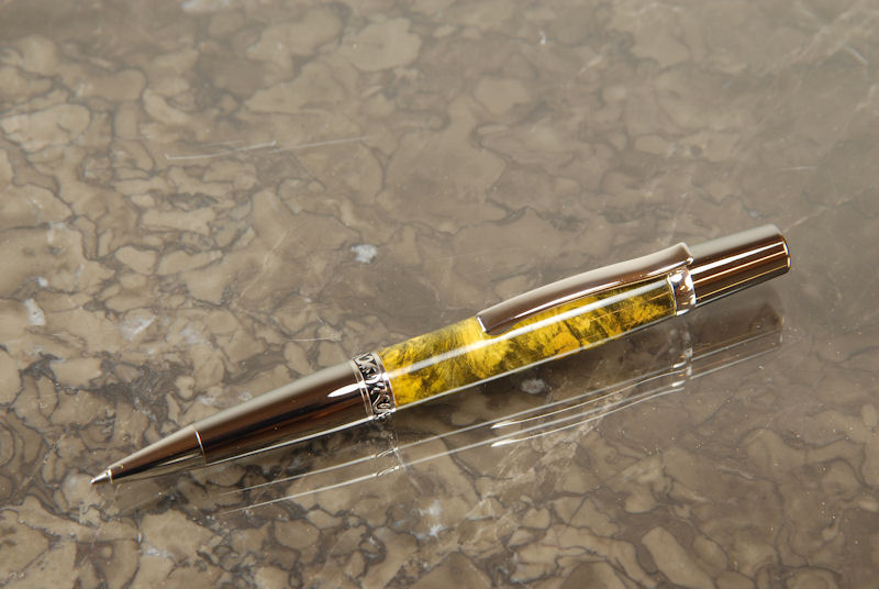

  • Elegant Sierra - Dyed yellow Box Elder Burl

nice looking pens... I think your yellow box elder may actually be buckeye burl, but it's beautiful either way.
Great looking stuff Keith. Did you put a "finish" on them? If so, what did you use? Also, I am sure it is a camera trick, so forgive me for bringing it up, but the Zens look over turned at the end.
No camera trick Hans. You're right, the blanks are over turned at the end and I don't mind you bringing it up at all :smile: When I first ordered the kits I forgot to order bushings :redface: I figured out that the Zen bushings were the same as the larger of the lower barrel bushings on a Jr. Gent. So since I had two old sets of the Jr Gent bushings I was using those bushings to turn the Zens. Well the sets are really old and one of the bushings must be pretty worn out. I neglected to use my calipers to double check and only found the mistake when I came to assemble the bushings. I'm still kicking myself, especially given how nice the red spalted hackberry came out. On the plus side, I know have another personal pen :wink:
