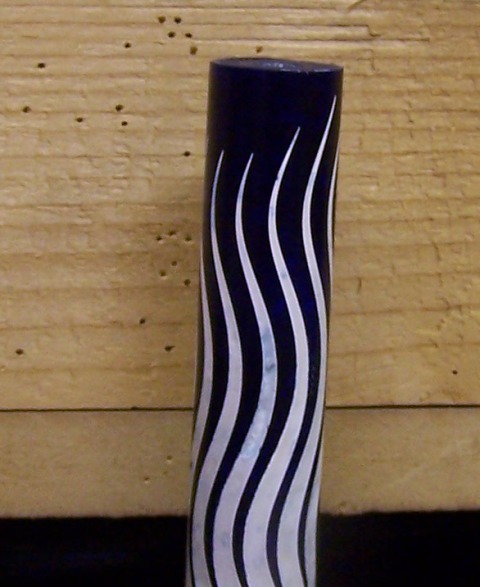

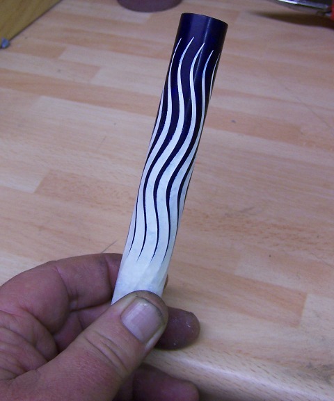

I must have made about 6 million jigs so far to make this :mad:, but I think my latest prototype is almost there:biggrin: I just need to tune it a little to make sure all the spike ends are the same
12 wavey spikes. I'm really pleased:biggrin:

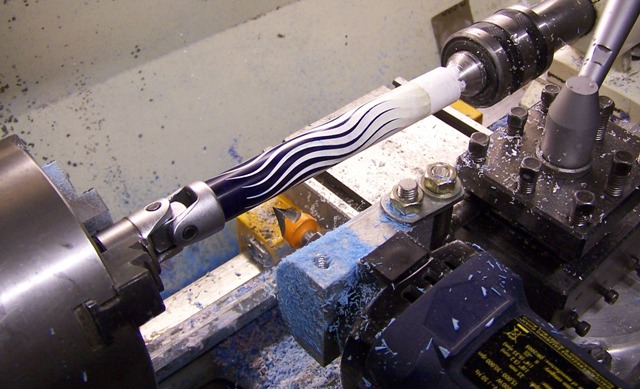

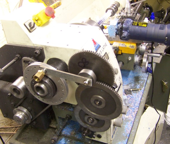

Small router mounted in toolpost, with perfect point bit.
Tailstock radically offset so I used a modified universal socket swivel to act as a screw chuck. Like a bottle stopper mandrel I guess.
I indexed the drive pulley with 24 x 5mm tapped holes and arranged the gear chain to massively reduce the ratio. I had to add another wheel to the chain, but it simply bolts on.
Then I made the eccentric cam. The connecting link has bearings to reduce slop.
With the exception of the pulley indexing, I made no other mods to my lathe.
The whole thing is driven by a crank which I have on the end of the leadscrew
The drive pulley belt is fitted in the pic, but it was removed to do the cuts. Of course the lathe was unplugged as well.
The blue pr was the main blank and to test this idea I simple painted the cuts and filled with CA. I will 'double cast' the next ones.
Simple huh?:biggrin:

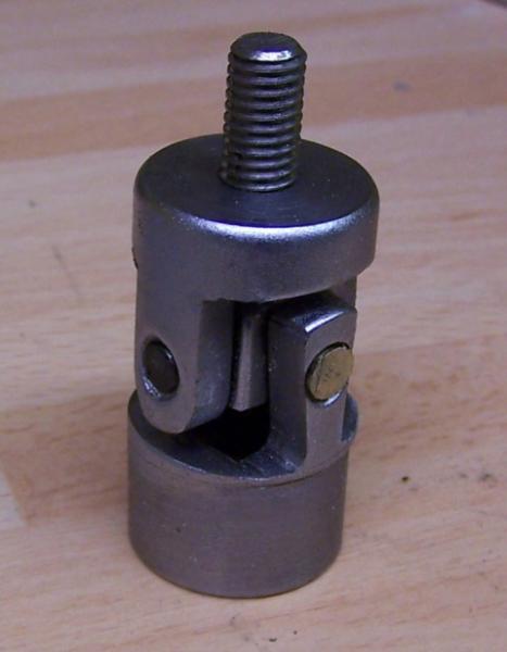

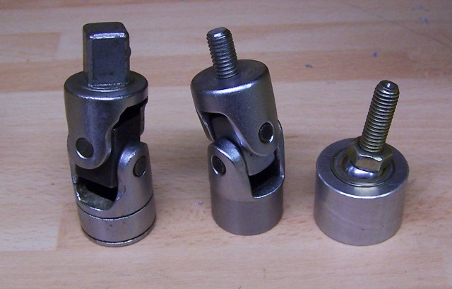

I figured that the reason the spikes didn't start or end in the same spot was because the universal joint from a socket set isn't really a TRUE one.
The axis of both halves must be on the same plane. Not offset like these are. If you have ever worked on a prop shaft on a car you'll know what I mean.
Now you can buy proper small U-joints for about a fiver but all the shops are closed so I thought I could make one from a swivel bearing that I had laying around........
I didn't realise the problem till I finished it, see if you can spot the error:biggrin:
The pic shows an un-modified joint, then my first modified attempt and finally the swivel one which is as useful as a chocolate teapot!!!

First thing I can think of is that the cup will turn with the lathe but the bearing will not. sort of like leaving a broken link in the chain. you can reach anything but when it comes to the pulling things aren't going to progress very well. By the way different starting points for the spikes is not necessarily a bad thing. Control of exactly where any given spike does start or ends might be though.

What I'm trying to prevent is the big difference that you can see in the pic below. I guess 'random' may be ok too, but I think un-even lengths will catch your eye as a mistake, like a poorly made celtic cross does.
John, this pattern will shrink a lot when turned down to size. I'd be lucky to get a Sierra sized blank out of it.
The swivel one I made is 'live' but of course should be 'dead' :wink:

Skip, yeah we are thinking the same thing. moves when it shouldn't. Now is that the tuct tape repair or the WD-40. I can never keep those straight.
By the way I still like the different lengths of the spikes. if they are symmetrical around the blank I like them even more. You may have "Accidentally" stumbled upon a variation fo what you are trying to create. I Cristin it the "Variant Spiked Blank"
For anyone that still cannot picture it. Skip made it so both ends of the blank are being held by bearings. I thought he was being a bit hard on himself with teh how stupid can you get comment considering how stupid he is not. But I do have to admit that is a rookie move at best. of course it does simplify turning the blank for the next cut though
A Mini CV joint is exactly what you need. not only will it swivel but be dead. they where made to take the pounding a lathe will give them.
