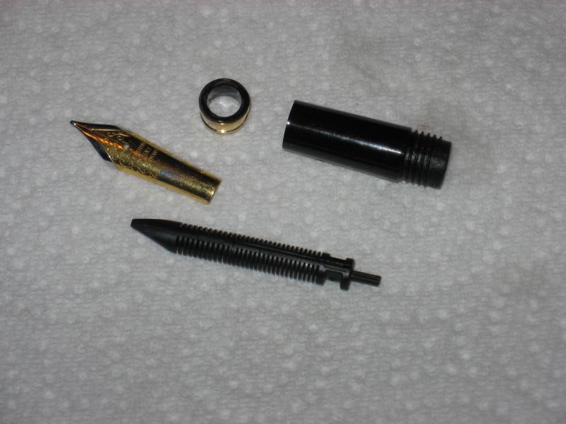

Has anyone ever replaced the nib on a Classic American style? How did you get it apart? What did you use?

Hans, If you're refering to the Woodcraft Classic American the nib pulls out. Gently grip either side of the nib and feed and rock back and forth (the nib not you) while pulling straight out. Both nib and feed will come out. The pic shows waht it will look like less the gold ring. A customer managed to crack it and cause it to leak. It shoud have been one piece with the holder.

They are sticky, but they will come out.
