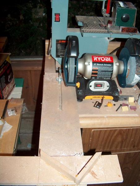

A little back story. I started turning about a year ago, got out of it and recently back in. Well went out on sat. and bought a Roybi 6" grinder from the orange place. I made a homemade jig for it (pics coming tonight) and sharpened the two gouges today, and let me tell you, it is so worth it. Cut like butta! The jig is adjustable and really simple to make, I made it out of MDF scraps left from the crosscut sled. So simple to use as well.

Dennis, I have been following along with your story the last few days. Seems you discovered that same thing many others have. you think you know what a sharp tool is until you get a sharper one. when you finally get all the way up to what I call Scary sharp you are starting to get where you needed to be all the time. Scary sharp means you start having thoughts of what would happen if you dripped the tool and it hit you in the foot cause it most likely going to mean an ER visit.
Interested in seeing your jig... But no photos, it didn't happen
WOW, forgot to post them here... Sorry.
Here it is....
And now that I have used it a few times, I can say, again, amazing difference!
Just have to tweak the design a little to work with the skew, and remake it out of something a little more stable then MDF. Also added a second bolt with a small block of wood in the front of the channel to aid in preventing it from twisting..
