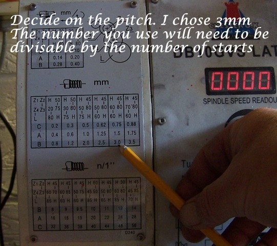

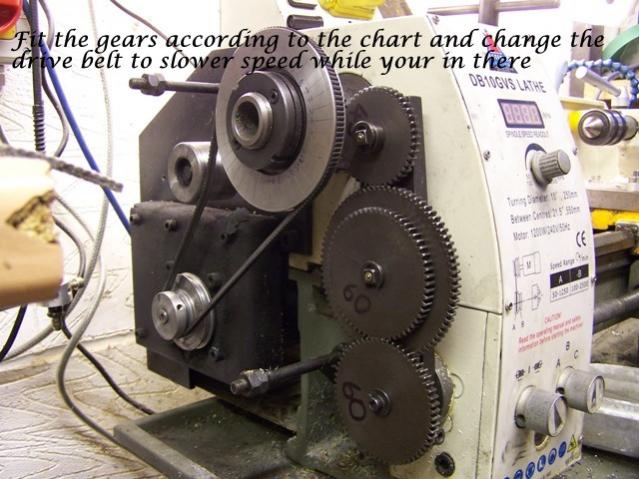

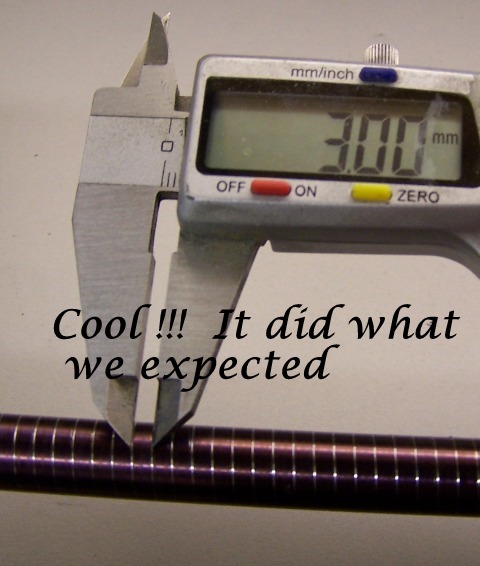

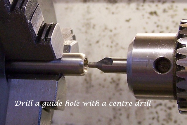

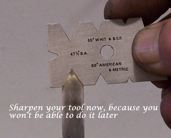

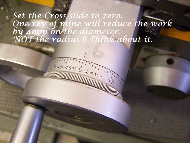

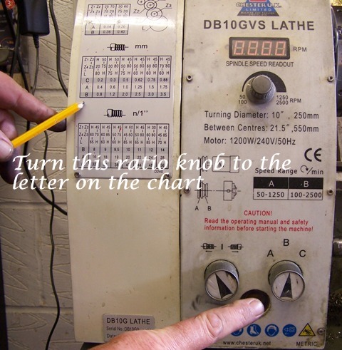

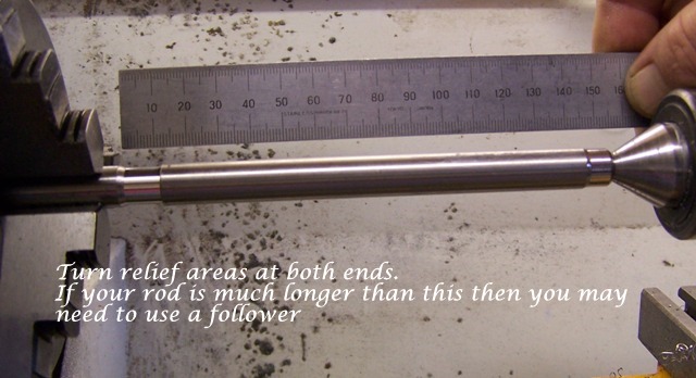

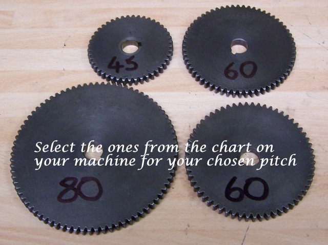

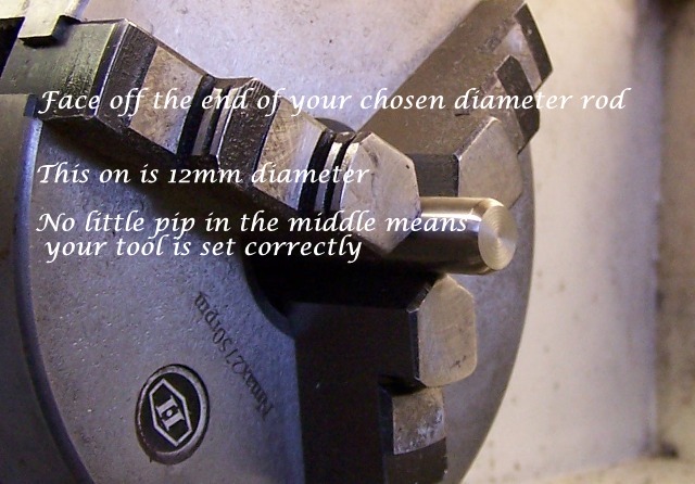

Here is a method of making 3 start threaded parts for your capped pens.
Before I get shot down in flames, I appreciate that purists will say the topslide SHOULD be set at 29deg etc etc, but I believe that with shallow fine cuts that doing it this way is just fine.
I will need to add some text that I couldn't fit on some of the pics.
This is just repetitive text so I'll only write it once even though you will have to repeat it several times. :biggrin:
The pics are numbered in the sequence that they are done, T1, T2 etc

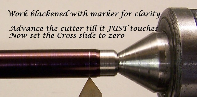

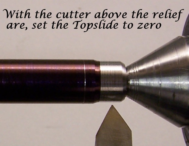

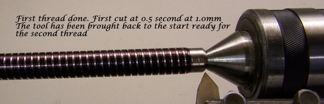

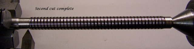

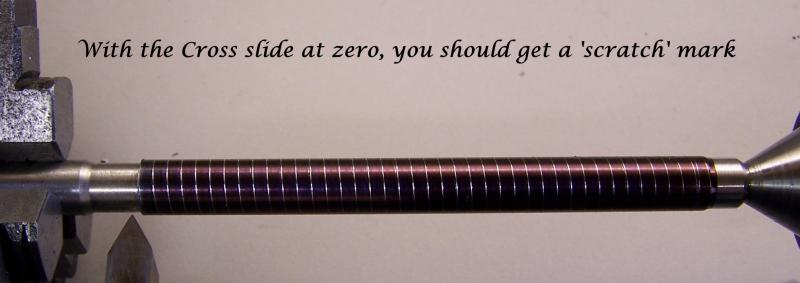

When you have done the first 'scratch' cut, back off the cross slide, then reverse the carriage till the cutter is back above the relief area near the tailstock. Now set the Topslide to zero.Now put the Cross slide back to the zero that you have already set.
I did each thread with two passes, first at 0.5mm then at 1.0mm. Remember to back off the Cross slide before reversing the machine back to the beginning.

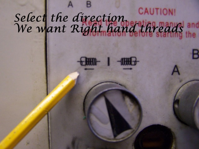

Also remember to switch the machine from reverse to forward !!!Or you will crash and burn!!

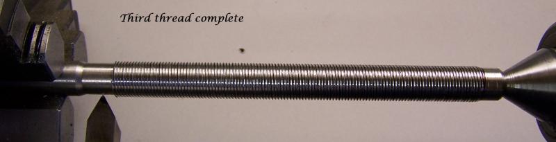

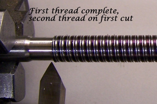

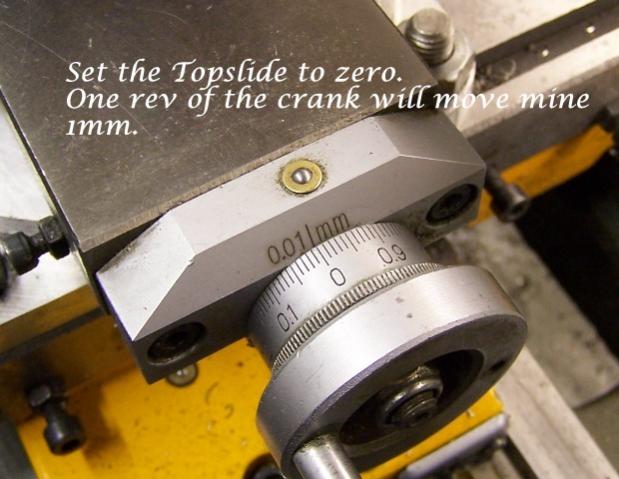

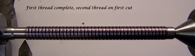

When the first thread is complete, and you have reversed the machine back to the beginning, simply advance the Topslide by 1mm. Now just repeat like you did for the first thread.
Same again when the second one is finished.

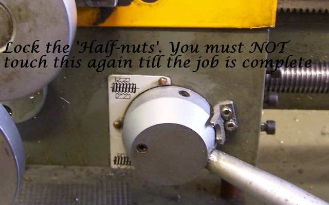

Things to remember are;
Don't forget to back off the cross slide before reversing.
Don't forget to switch back to forward before cutting
Don't lose your zero points
and NEVER dissengage the Half -Nuts till the job is complete.
These instructions are for a manual change gearbox and a metric lathe doing metric cuts but the principle should work on any lathe

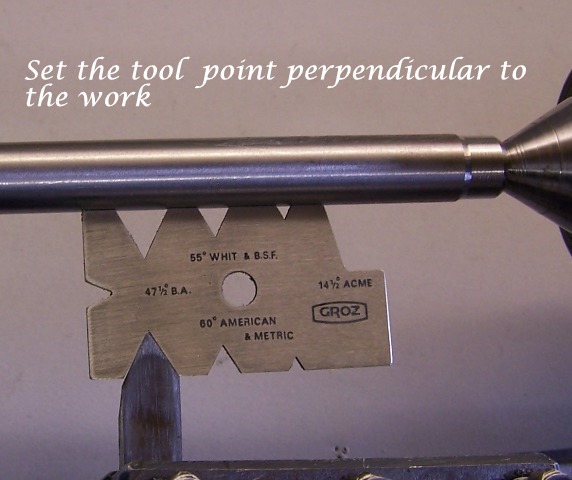

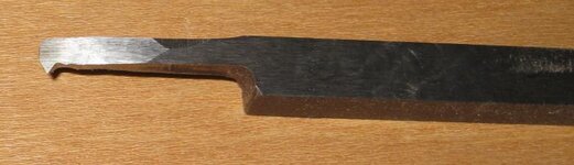

Steve..I see you have a tool in which to compare your thread cutter to. A guage would be a better word. Is there different size cutters for different threads, or does one cutter pretty much cover all threads?
Jeff, the size isn't as important as the angle. Notice on the gauge that the one side is 60", while there is 55" on the opposite.
60" is the standard for us. But as long as both the internal and external threads match in terms angle, you're fine.
