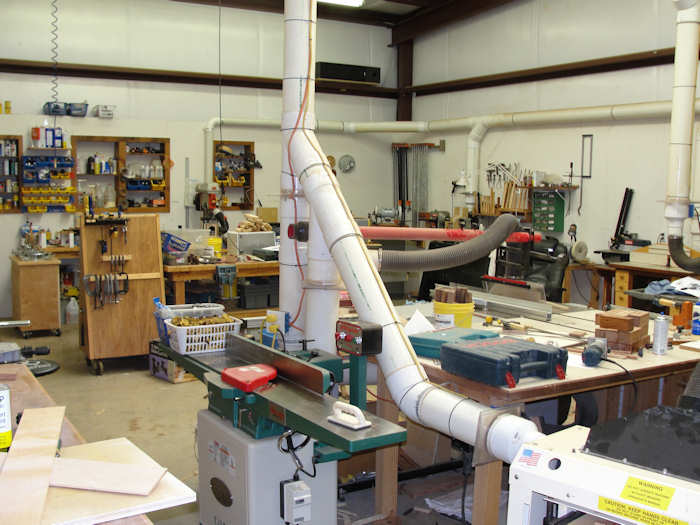

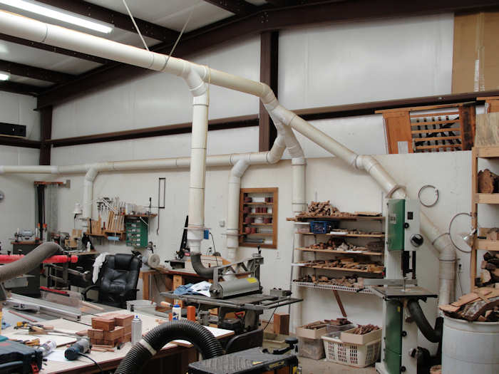

This is some of my duct work. It is all 6" PVC with short 4" PVC drops. When possible, I ran PVC straight to the machines but occasionally, I had to use a really short (2') piece of flex duct.
This is one of my main drops. It branches to the 8" jointer, the 18" planer/molder, and my Unisaw. Each is individually controlled with blast gates.
This is going to the far side of the shop. these drops are for my Performax 22-44 Pro drum sander, my 18" Rikon bandsaw, a floor sweep, my Norm Abrams router table, my lathe, and my drill press.

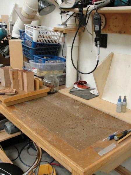

This is a downdraft table I built into one of my work benches. I use it when gluing tubes to evacuate the CA fumes as well as anytime I am sanding with the palm sander. Of course, the palm sander is always hooked up to the shop vac to so I get all of the dust from it. You can also see the miter saw on the left.

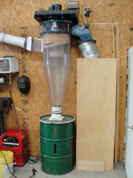

And last but not least, the heart of the system, my Clearvue Cyclone.
Here is a really cool video I shot of the cyclone in action. You can really see how it works and how effective it is. The first scene is pickup up MDF dust from the miter saw as I made a couple of cuts. As you are aware, I am sure, MDF dust is really fine and terrible to try to collect.

That's an awesome setup! Is the cyclone in a separate room? did you build your own blower/housing etc, as looks different from the ones on clearvues page, but i noticed you can just buy the cone itself? Is this the 15" impellor version?

You make it look easy! The efficiency of well constructed and sealed joints along with good gates can easily be missed by many. That looks like a small DC unit for the amount of pipe you have - which strongly suggests your experience and penchant for precision and detail!
The gates - Did you make them, or most of them?

My shop is 40' x 75' but my woodshop iteslf is one end of the building walled off from the rest. It is 25' x 40'. The DC is outside the wall that seperates the 2 area. The wood box on the right side of the pic is where the .3 micron filters are located wtih a hole in the wall to return my air conditioned air back into the shop!
I bought the complete cyclone from Clearvue 2 years ago. They may have changed some things since then. When I bought it, they did not have options on different impellers so I am not sure what mine has. I know it works GREAT though!

I actually calculated the static pressure drop for each run and each machine to make sure I was achieving the amount of air flow at the machine that I needed for proper fine dust collection. Each drop exceeds the minimum by quite a bit.
Was just going to ask if you had calculated the static pressure! Do you have to reduce the 6" pipe for many of the tools? As most in the UK have 4" DC ports at the most!
My belt sander has a 2.5" and my scrollsaw has nothing! And there the two that create the most dust!

In picture number two down from the top ... Is that a tool holder on the top of the wall and above the bandsaw to the right??
IF so, just how danged tall are you?
