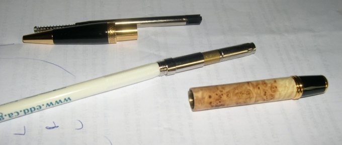

Dave and others - The problem cannot have occurred in the manner described. I just went through every measurement and it simply is not possible.
You see, the threads that hold the transmission unit in place will only extend approximately 2.31 mm before the threads disengage completely, thus the unit cannot be further jammed up into the cap unit. The play in that area is approximately 4.73 mm. The transmission unit would, by necessity, have to be jamed up into the cap unit by more than 4.73 mm before the transmission would not engage. I offer a different scenario of the conditions that lead to the failure.
If the transmission was unscrewed from the nib section, which is very possible in a twist mechanism which is screwed together, the customer separated the upper section from the lower by unscrewing the pieces completely. In putting the two pieces back together, the top of the refill was not fully and properly seated in the top section. At that point, the pen could not be compressed sufficiently to engage the threads for reassembly. Rather than rotate the refill until it fully seated, the client forced the sections together, thus pushing the transmission more than 4.73 mm into the cap section, thus bypassing the grip/actuation area. This is why the barrel then rotated freely without engaging the transmission to raise and lower the refill.
Design fault or customer error? I don't know. I do know that if you teach your clients to pull off the top to replace the refill, this problem cannot and will not occur. Can customers botch up a pen without a design flaw? You bet! I have had a customer strip the threads of a roller ball pen by deciding that my screw caps must be snap caps. But with a little self-education and a little customer education, this problem can be avoided 100% of the time.

sorry, but when I tested my Sierra's the transmission was indeed stuck in the cap section. I can NOT get it out without ruining it. I can pull off the top of almost all (8?) of my last 10 Sierra's that I did all this week - each and every one will have the transmission stuck in the cap.

Ruth try like I posted and get a bic pen and quarter turn it into the trans section till it grabs then pull the trans out. There is no need to ruin the pen unless you just want to. I did this exact thing on purpose trying to figure out the original post.

Nolan: Thanks for the picture. Great idea!! I would never have dreamed that you could grab the smooth interior of the transmission in that fashion; but, obviously, you can. You learn something new here every day.:D
