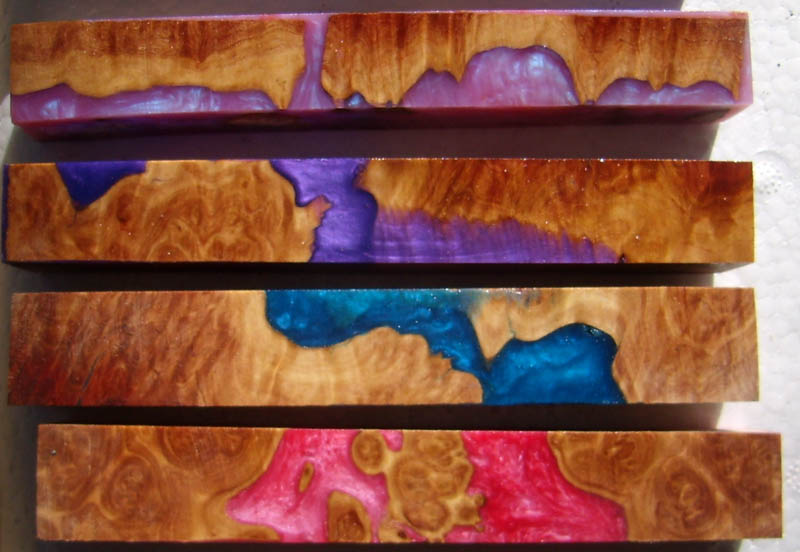

First off is the Red Mallee Burl cap cast in Two tone Blue/Purple, Purple (photo doesn't show colour quite right), Bright Blue and Candy Pink

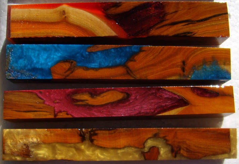

Next, Conkerberry with Blood Red (dye), Bright Blue, Maroon and Gold

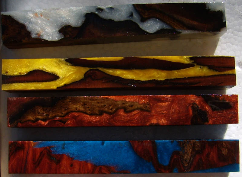

Then my burnt Budgeroo root with White Pearl, Bright Yellow, Copper and Bright Blue

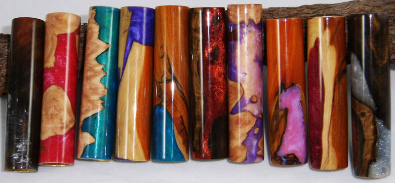

Couldn't resist turning a few of these types, so I turned some short ones as Sierra blanks, now just have to wait for some more kits to put them in. The cheaper Sierras I have don't suit.
I've also been casting pine cones and banksias. I turned a few of them

Yeah, I realized when I saw them on finished Sierras that they were half blanks turned to final size. I thought they were still full length, and oversize- which would make finishing with CA odd, given that you'd remove it when turning to final diameter.
Very nice, though!
