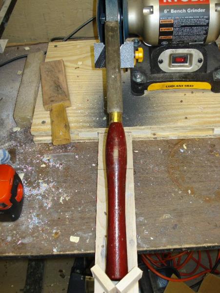

Until I can afford the pro setup I made this but it does require a grinder.
