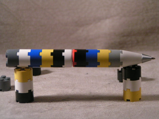

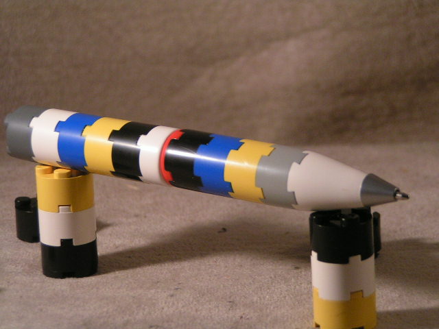

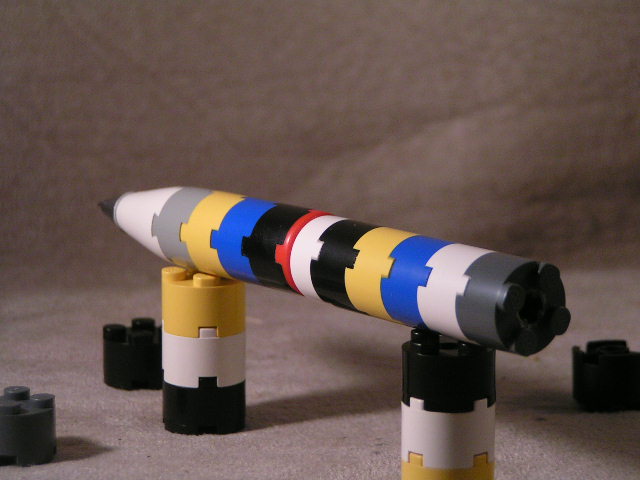

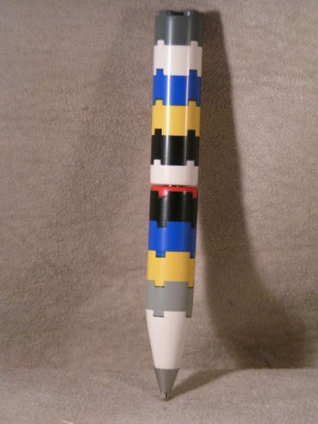

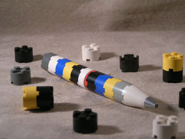

I saw the Lego pen that Hans made, and I liked it alot, so I went on ebay and bought some. Since Im not that advanced, I made a twist pen rather than capped.
As always, comments and critiques are greatly appreciated.

Good work! How did you drill it? I found the lathe and collet chuck to give me some really close to center work.

I set the drill press to about a 1/2" from the bottom of each piece. I centered it the best I could by eye and just plunged the press down and out quickly so I didnt melt the plastic. I used dental picks to pull out the drilled material left inside. I used 7mm drill bit. I am going to try sierra size next.
I had a real hard time with the finish. Tough stuff to work with.

Yep melts easy. I found it best to glue most of the pieces together first, then drill. YMMV
