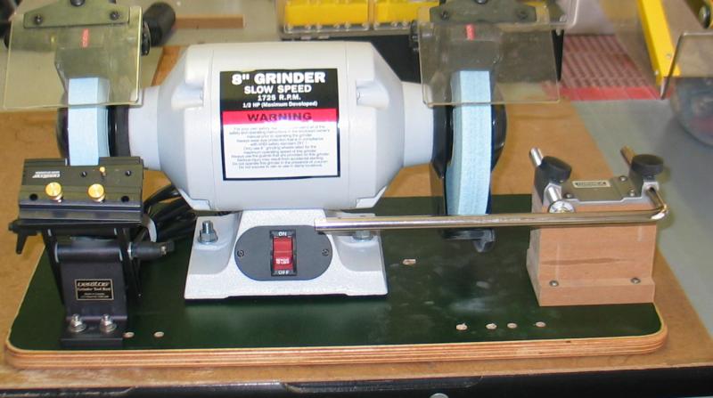

  • After I studied the diagrams about 15 minutes, another 30 minutes to install for me because I already had my grinder on a platform -- I did have to shift the grinder to the left 45 mm to accommodate the mount.

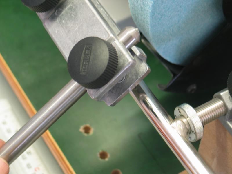

  • A bit pricey at ~$57, but that does include a tool rest/universal support (US-105 - $38 value) and anyone using a Tormek knows the benefit of an extra tool support arm! You can buy the XB-100 horizontal mount for $23 if you want to save and don't need another tool support (install instructions are on the tormekusa website)
  • Instructions are a bit spotty, but the diagrams/dimensions are reasonably clear. I had to derive the location of mount relative to the front of the grinder (15 mm - example diagram had mount&block on the edge of an 8" platform for an 8" grinder so not that tough to figure out).

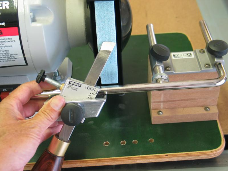

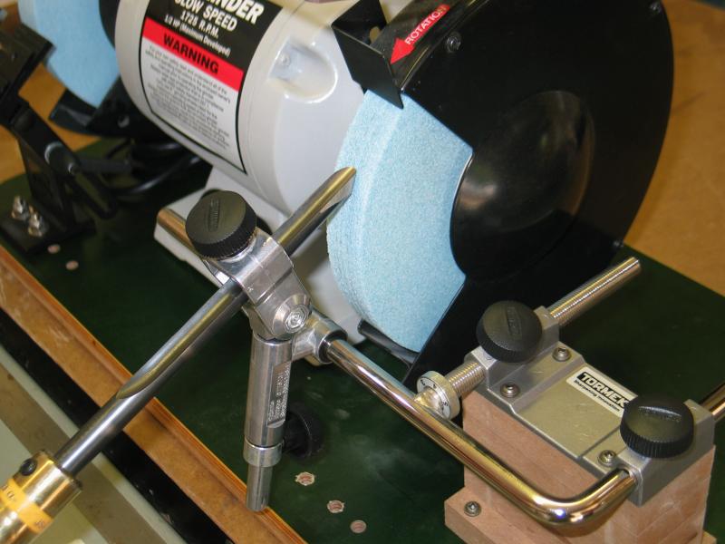

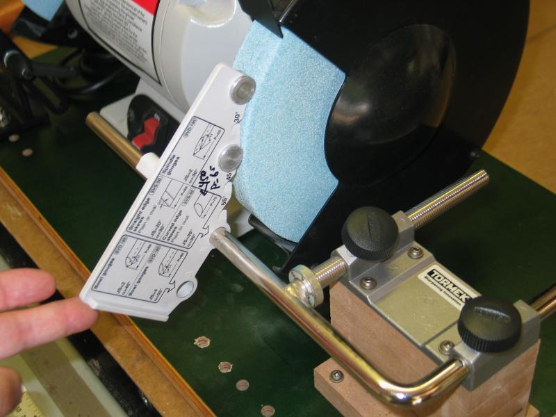

  • Not all Tormek jigs are supported (probably something to do with grinder wheels normally shrouded in a cover) but all those I use for turning tools are: TTS-100, SVD-185 (swept-back gouge jig), SVS-50 (skews and straight gouges) and SVD-110 (tool rest for scrapers)
Neutral:
  • Not sure the best way to get the grinder wheel dressed parallel to the support bar -- I use a LV single point diamond dresser so I just put it in an older SVH-60 straight edge jig to dress the wheel. I thought about using the Tormek truing tool, but (a) I didn't want to risk ruining the truing tool using on the much higher speed grinder and (b) almost no room for support arm adjusting nut movement in this application. The BGM-100 manual recommends a standard diamond wheel dresser but I don't have one.
Some photos of the setup and feel free to ask any questions. I bought mine from Jeff Farris' sharptoolsusa online store.
