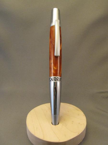

I guess I was lucky. I bought 2 of them and have only turned one in a Wall Street II pen and did not have any problems.
